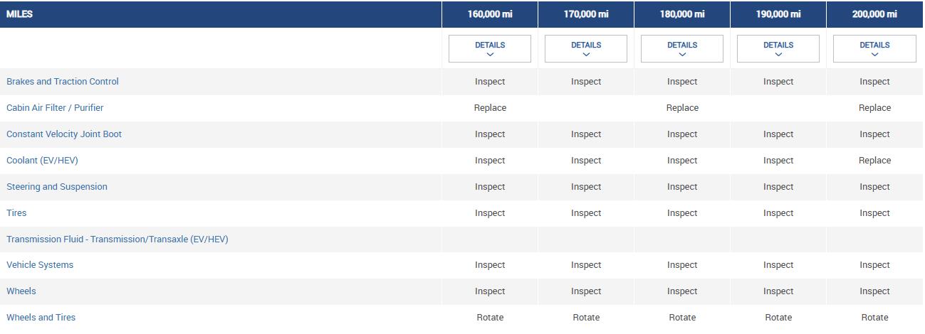

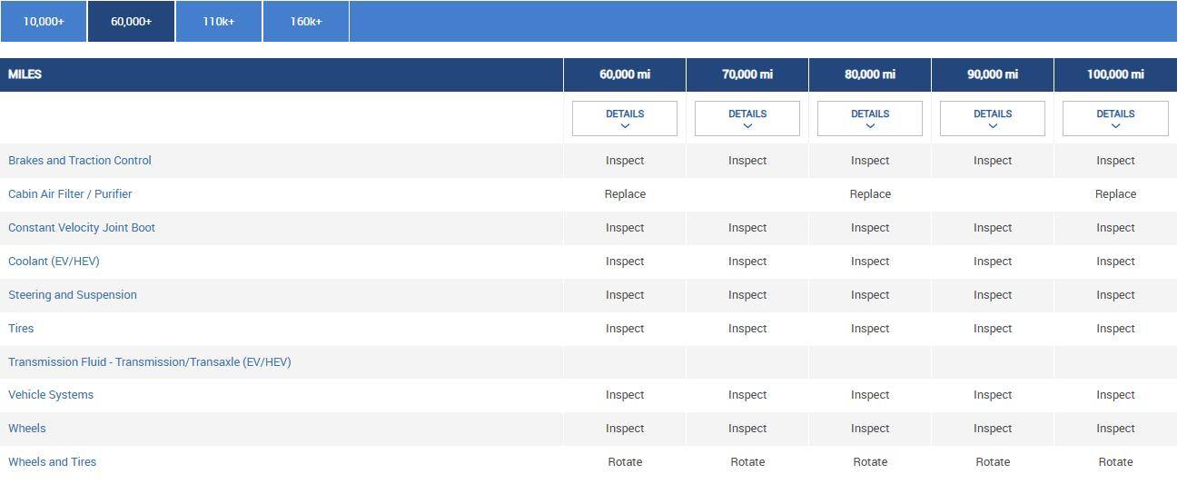

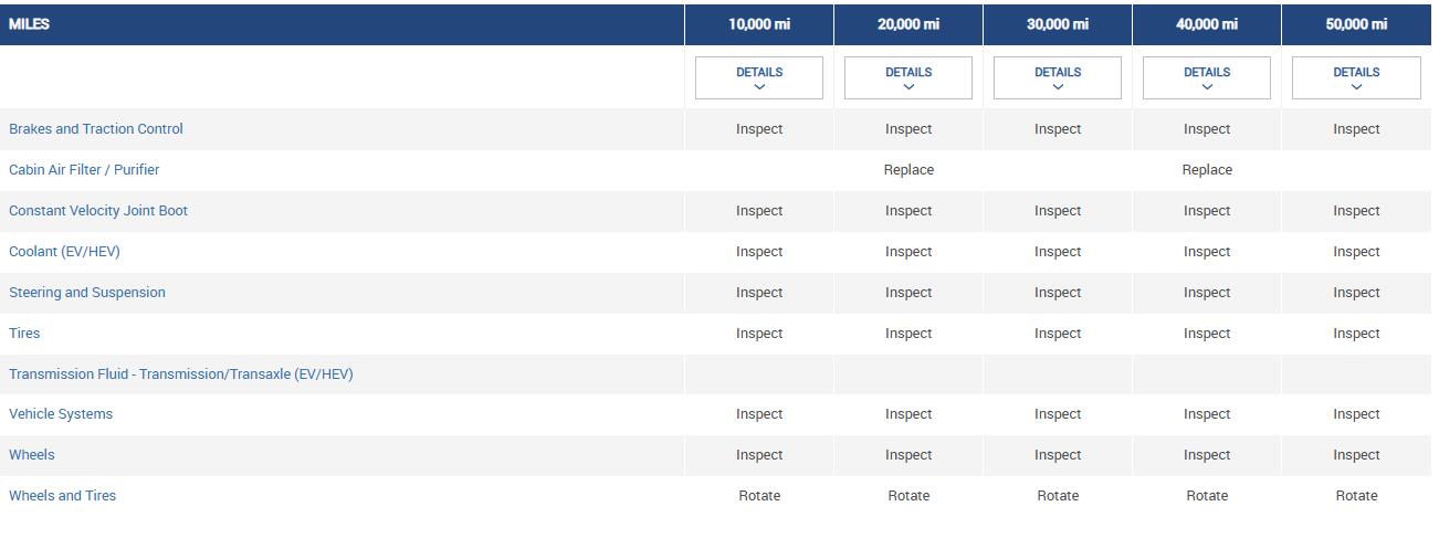

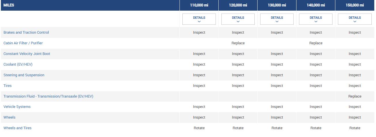

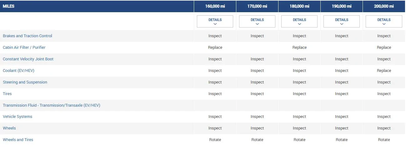

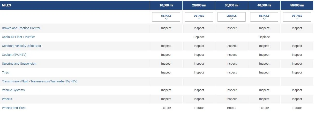

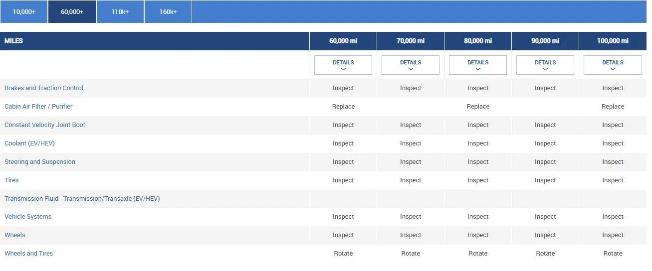

nothing is maintenance free. but the service intervals are drastically increased. for instance, here is the maintenance recomendations from ford for the Lightning...
I suspect that the slate will be similar. tires, cabin filter, washer fluid, wipers, and just inspections for the first few years, then change the coolant and gearbox oil.
You will notice that most items are inspections until you get to 150,000 miles, then you change the transaxle fluid and filter (Front and Rear Motor), coolant changes are the next bit maintenance item, and it isat 200,000 miles...

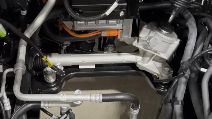

Plus power steering fluid if I understand correctly.
Will there be refrigerant?
No power steering fluid...
The slate will have an electric steering gearbox, you can see it in the video with Sandy. so there will be no maintenance here.
