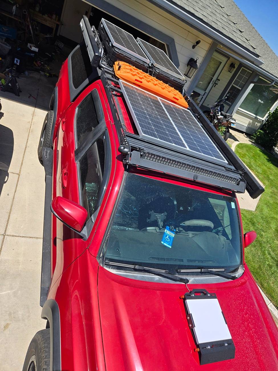

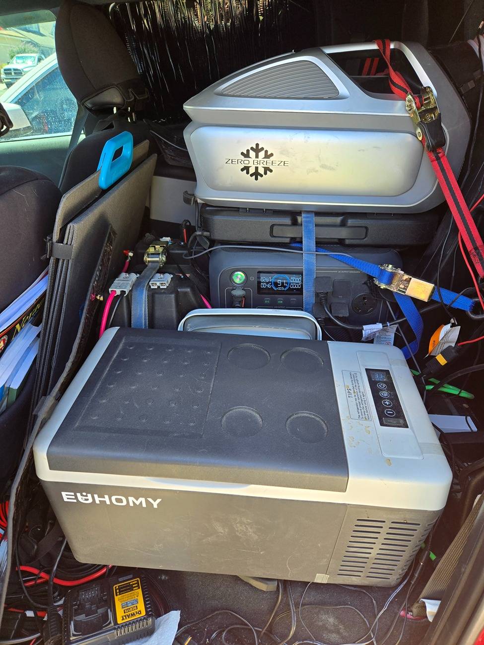

Just kinda poking through this thread, lots of good points. Just thought I'd share what 4 rigid Renogy solar panels looks like on my Tacoma...for different reasons obviously as Im a huge outdoorsman and sometimes spend weeks out in the desert hours from anything so being self sufficient in an unforgiving environment is critical. You can see of the 400watt panels Im currently bringing in 281 watts to my Bluetti power station. Might be a little better if I cleaned the panels 🙃

YES!
but that light bar will take all the sun can hand it!
I also drive a Tacoma, maybe I should get one?
