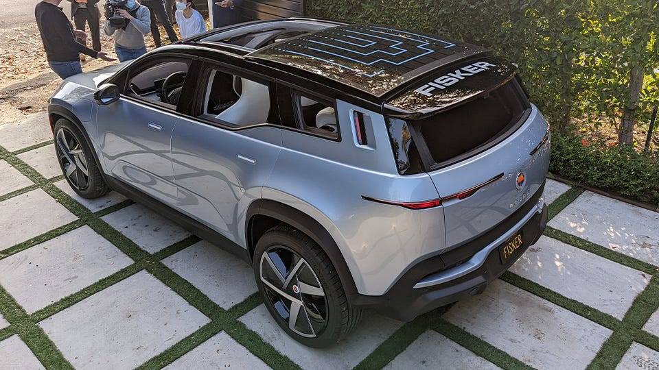

Fisker tried this over 3 years ago on the Ocean. To be any way effective, the plane of the vehicle’s roof needs to be at the perfect angle to the sun all day long, which is pretty much impossible. While most considered this a novel idea, it proved to be more gimmick than function. Sadly both Fisker and the Ocean are no more.
