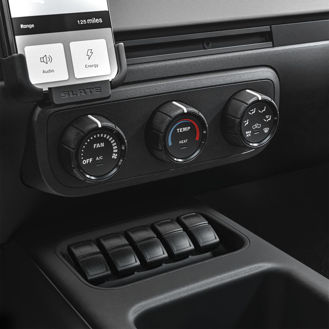

Oh yeah, you can definitely see it in this pic, those are physical indicators
I thought I read that all the cabin heat controls were simple mechanical things. Even if true, I could imagine that the fan speed is infinitely variable by making the knob on the left a 0-5k or 0-10k pot with that voltage signal controlling the duty cycle of a single power Mosfet to moderate the fan motor speed. If it was me, I would take the precaution of having the first 10% of the range equating to off and the remaining 90% going from 10% power to 100% power on the heater fan.
Now that we have them, a single power Mosfet might even be simpler than in the old days when there were multiple leads on the motor and the heater switch (rotary type) picked which ones to apply power to. Also, it might be a trick to now find an affordable 12 volt fan with multiple field taps.

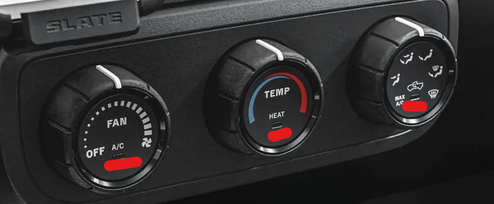

I'm guessing digital. The vertical indicator looks like its located more as a center reference point than a current setting position. Ive got this kind of knob on a few cars; it bounces back to center when you let go and its usually only the outer ring that rotates; the inner 'button top' is either stationary or another push-type button on its own.
I don't think they bounce back to center. These certainly didn't.

I kinda hope they are just knob-knobs and nothing complex. Less to go wrong and easier and cheaper to replace.
BTW, whats the "FN" stand for in "Slate FN"? I saw it when you mentioned a VIN in another thread too and wondered.

I wonder how the switches work. Specifically, there seem to be indictor LEDs on them.
In my wild imagination I would think if I want the AC compressor to run the fan switch would need to be in any position except off. And I would push the center of the dial and the LED would light light up indicating AC the compressor is running. The center button, if it is one, could be a momentary switch that must be pushed again when the truck boots up or a switch that stays pushed.
The temp switch has a heat LED. With the LED off there is no heat generated. Just like an ICE car you don't need one or both engaged.
The knob on the right looks like you push it to engage recirc. Max AC should automaticity engage recirc like it does on my 55 year old Ford. Defog may turn it off. Some cars shut off recirc when defog is on. On modern cars recirc is a choice for several modes. Or maybe the LED lights on max AC only.
This is how I understand it to work. From what I’ve heard, the FN heating is a glycol hydronic PTC system that also provides battery heat. In this case the center knob rotation may control flow through a cab heater core.
In addition to shutting off air recirculation, Defrost usually also engages the air conditioner compressor to dry the air.

I guess I read into this too deeply. I remember the time when the air distribution selector was full on mechanical and that slide selector actually pulled a cable to engage the distribution flaps under the dash. Sometimes it was hard to select. And sometimes it wouldn’t stay put when driving and you had to keep correcting it.
So yes expecting these knobs are fully electronic that are articulating a servo to make those distribution and temp selections. Cost and reliability should be there now without added cost.
Its pure gravy if they are remotely controlled but highly doubtful as that = expense.
