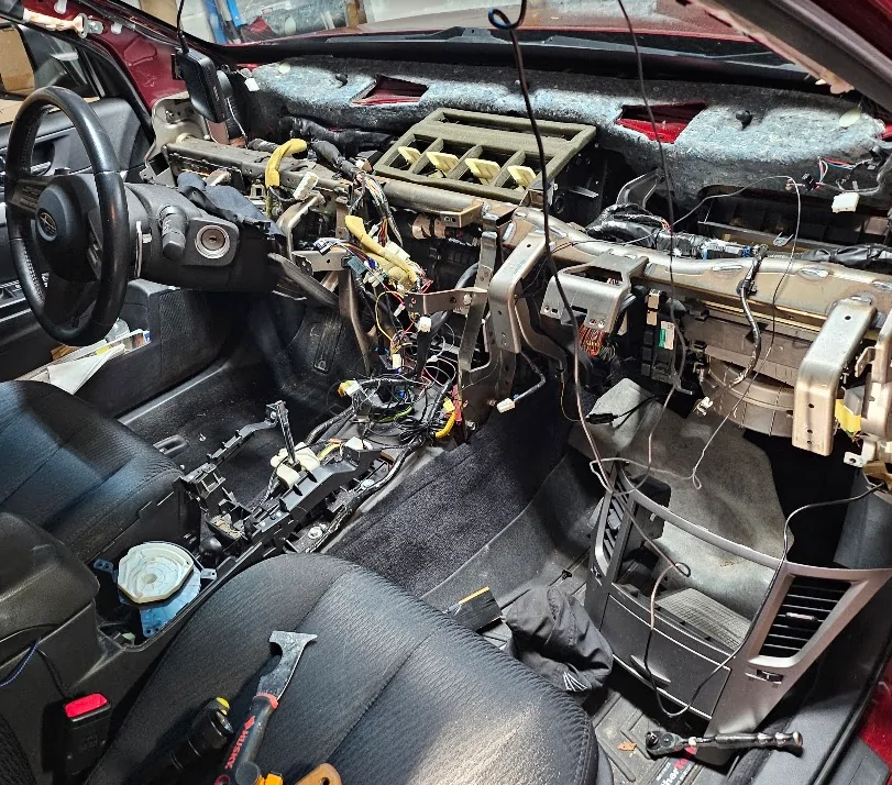

Amen to that. My Subaru was great, but the blend motor buried in the dash would slowly fail over time. They all did it. This motor controlled paddles to direct air to the top or bottom. If a cable actuated it, it never would have failed. Instead, this is where I found myself a few years ago. (It is not a crime scene and yes I did successfully get it back together.) Slate has 700 parts. I think I manipulated 700 parts to get to that motor. :)
The way modern car dashboards are assembled is utterly ridiculous. My 1989 BMW E30 325i was so well designed. 3 sliders for air direction (windshield, torso vents, floor vents). One dial for temperature control (hard-wire cable actuated blend door). And an electronic rotary control for fan speed, which fed a stepped resistor pack. If the fan speed switch failed, the resistor pack went to zero and only high speed was operable for the fan (easy way to diagnose the system). The resistor pack was easily accessible through the cowl in the engine bay under the windshield. Take the access door off to the HVAC blower motor fan, plug in a new $20 resistor pack, and it was fixed.
