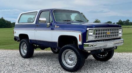

Here's another way to look at it: You could buy an 80's K5 Blazer SUV with or without a seat in the back. It's always an SUV, never a pickup with a topper. The reason is because the Blazer's removable roof, while similar to a pickup topper that's been around forever, is fundamentally different.
I doubt the removable back wall of the Slate's cab functions as a rollbar. If you think it does, then how do you explain the Cargo Kit being available? The purpose of the SUV Kit's rollbar with airbags is to protect rear passengers in the seats.

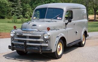

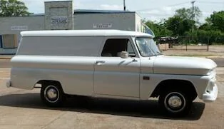

Panel Trucks have been around forever, too. Probably longer than pickup toppers.
50's:
60's:
