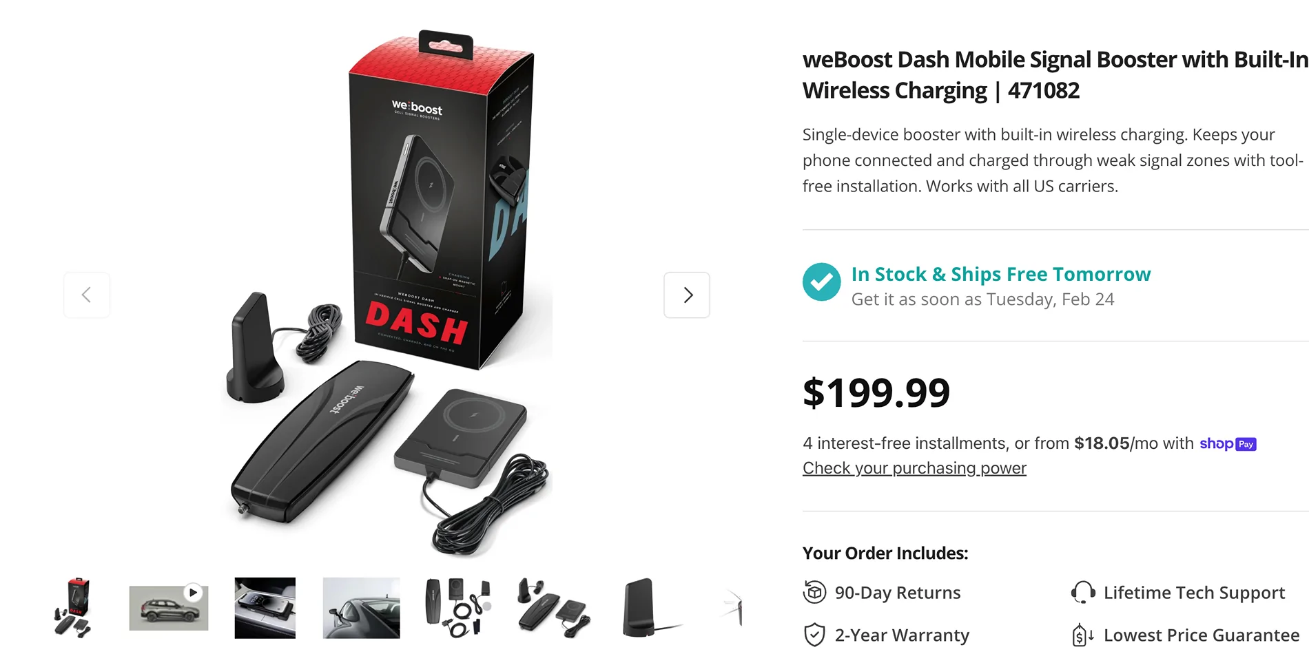

Yes, I use the WeBoost cell booster while in car.
Good price for what you get.
You have to run a shark antenna outside for best performance.
Slate Auto Pickup Truck Do vehicle Internet Boosters work? Screenshot 2026-02-22 at 11.17.07 AM
