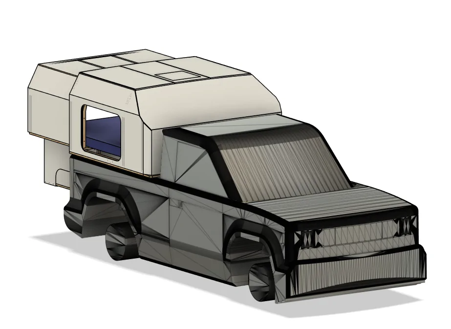

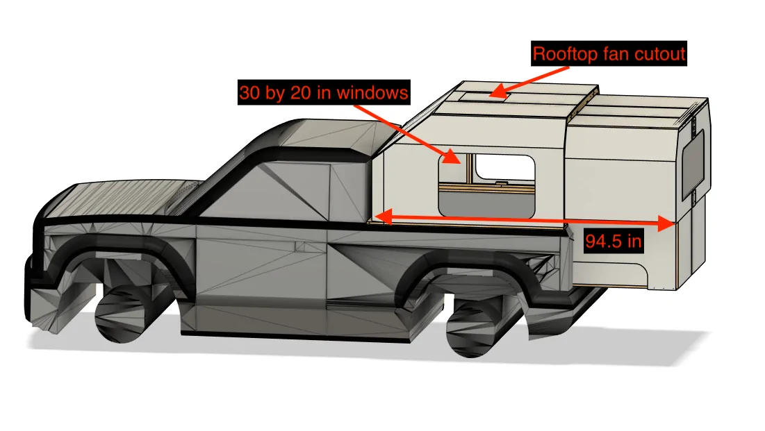

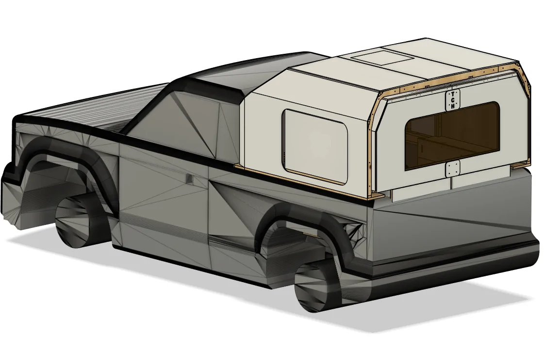

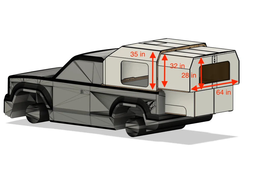

Would love some feedback on a hard sided camper design I created for the Slate truck. In the spirit of keeping prices low, I’m using all CNC cut engineered plywood that weighs around 250lbs for the outer shell and slide out. I highly recommend sealing the shell system with an ⅛ in coating of Line-X to keep the water out. It also adds ding protection, insulation, and strength to the shell system. This adds about 50-60lbs bringing total empty weight to just over 300lbs. I do have a nose over the cab model that you can see on my website, but I was trying to keep this design as aerodynamic as possible while still offering more space than a fiberglass cap. One of the pictures shows how you could place a 4 inch thick queen mattress (60 by 80 in) on top of the bed rail. There are several other interior build ideas I have that can work with the slide. There are a lot of options for windows, and I’m showing cut outs for the ones I like which are 30 by 20 in exit windows that can be left open in the rain. A cut out for a roof top fan and a very large hatch door over the tailgate. You could do an annex room like the rooftop tents under the large hatch door to have a nice covered stand up space for cooking.

I like the idea, and that size is a perfect for doing occasional camping while still fitting a larger mattress than a truck bed tent. The only thing I would change is some way to pass through to the cabin. You'd probably still want the midgate in place, but being able to either remove the glass and seal to the cabin, or have a flip in panel that allows you to also flip the glass in would allow you to use the truck's HVAC.

It's interesting and I appreciate the effort. I'm curious what the motivations for constraining it to fitting inside a closed tailgate comes from? Tailgate down, or removed entirely, opens up 1-piece shell options.

Fitting it inside of a closed tailgate seems like an unnecessary (over) constraint.
I assume the thinking there was that the tailgate becomes the support when it's extended.

You can leave the tailgate down and drive with the slide out to the end of the tailgate. I'll figure out a way to lock it in. Also was thinking you could remove entire slide in and maybe have a fabric door of sorts for covered hauling, or just remove shell with a friend (outer shell is under 100lbs).

Access to the hitch mostly, but you could do a single shell with my nose over model. I was thinking mostly about aerodynamics/truck caps with this design since mileage is important with an EV.

I believe there are restrictions on camper shells extending onto the tailgate. Has to do with visibility of the tail lights. There are, of course, ways to get around that with kits that extend the tail light structure further back.
