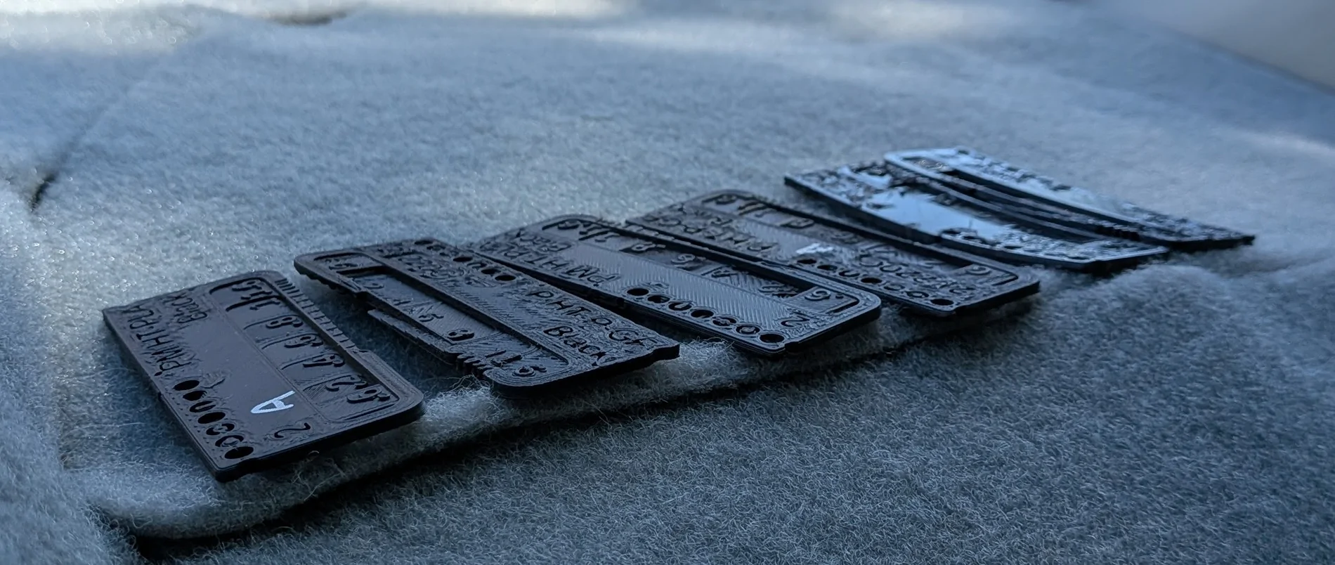

I printed some swatches of PETG, HTPLA and HTPLA-GF from polymaker a few weeks ago, and annealed 1 each of the HT types and they have been living sitting on top of my dash in high desert heat since.
Color can make a big difference. I tested black and transparent PCTG and the black warped badly in AZ direct sun while the transparent didn't warp at all. My experience with the HTPLAs is that they're really difficult to anneal without dimensional changes unless they're GF or CF reinforced. And the CF/GF reinforcement really compromises the strength.
For automotive parts I typically use ASA for stuff that's not structural and PPA-CF for stuff that is. PPA-CF is a little expensive and you need an enclosed printer with a 300+°C hotend (Ender 3 owners need not apply), but the strength, stiffness, and heat resistance is phenomenal.

I left the parts on the print bed, covered it with a heavy towel in multiple layers, and turned the bed heat to 100C and timed 30 minutes once it reached full temp.
Yeah they were flat parts, still stuck to the bed, but I can't find a difference between the annealed and non annealed, plain or GF. I used black for everything, since I figured it would be the most likely that I would use for the truck.
Still got to figure out how to test them with weight.
Hard to tell from the image, but the HTPLA ones have had from what I can tell zero warping, stack them up and they appear dead flat, annealed or not, while the PETG is obviously warped.
I've now rigged up a very basic way to weight test them, not much weight, but these are only thin swatches, probably have to wait for a bit to get any result, windy and not even 90s until next weekend.
This HTPLA is printed at 210-230C, annealed at 100C, and supposed to be stable, no warping or other deformation to 150C with no load. I've measured in vehicle temps in the past up to 150F(limit of thermometer), which would be 65C, well into the sagging range for normal PLA.
If the vehicle was to get to 100C water would literally boil, ordinary water bottles would burst, so highly doubtful it's getting that hot.
So in theory this formula should be fine for decorative parts like slatelets, and temp shouldn't be an issue at all for things like taillight covers, though with time UV might be an issue, and it hasn't been tested for UV, a good paint job should block UV if you wanted long term use.
For automotive parts like under the hood of an ICE vehicle, it may get even hotter, so people had issues with 3d printed air intakes and such, and this HTPLA may still not work for weight bearing parts like phone mounts.
