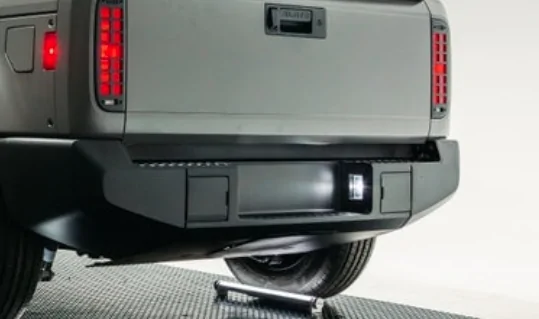

My guess is that a hitch receiver that mounts to the frame will come through a port in the bumper below the license plate notch.
On this bumper? How would that work?
Could see it either being right in front of the plate recess or possibly underneath. Alternatively I see 2 square ports there, behind that is rhe metal core for the bumper so there could possibly be some sort of oddball factory hitch for the rear bumper that mounts to those 2 spots with the hitch in rhe middle. Who knows.
1000lbs just doesnt make sense in any real way and seems like its more indicative of either a bumper hitch or engineers just covering themselves. Thats less than various crossovers, compacts and vehicles like the maverick that have similar price points, or less or slightly more.
2,617
One of the squares is used for the latch of the Spare Carrier, so I doubt it would be used for a hitch also because that would preclude having both a hitch and a Spare Carrier.
