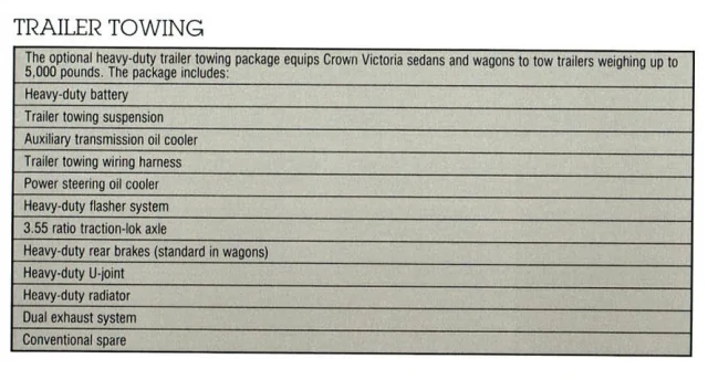

^This, I know a few people who have towed pretty big trailers with Crown Vics just by putting the bigger hitch on it and a brake controller, but the factory package included a whole lot more:
Slate Auto Pickup Truck What limits the Slate to 1000 pounds towing capacity? 1757468747281-st
