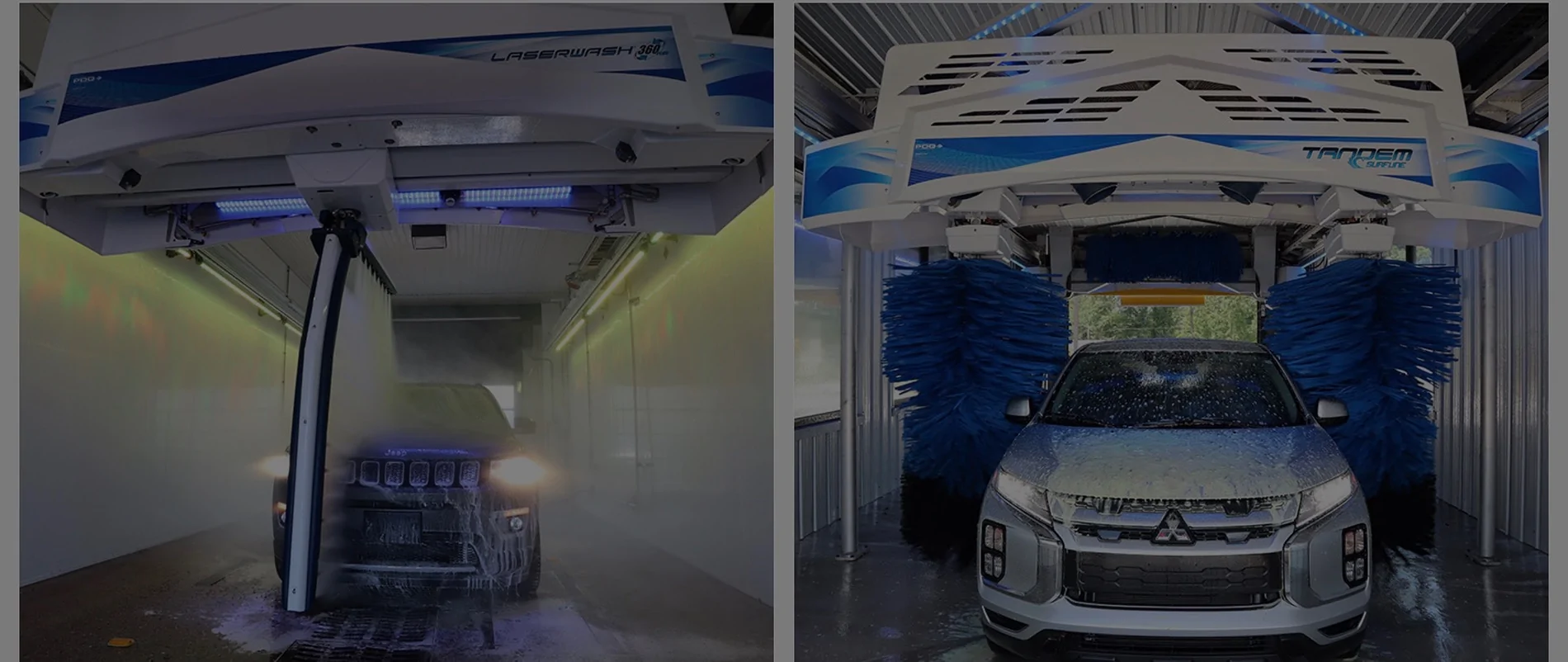

Here is my 2 cents of long information. I personally have a couple of car washes. One is a 3 bay all touchless bays. The other site has 3 bays, one soft touch bay and 2 touchless. I have a lot of customers with wraps and vinyl lettering that wash mainly in the touchless bays, but I have some that swear by the soft touch bay. The touchless bays high pressure rinses run at around 1050 to 1150 psi at about 14 to 16 inches off of the vehicle. I have never had a complaint of damaged wraps. I have been in the car wash business for a very long time and at the beginning of my career I built car washes for new investors. So, what I will tell you that could damage a wrap or vinyl lettering in a touchless bay is zero degree nozzles. If they are not setup correctly with the proper speed and distance from the vehicle the Vinyl will start to peel. Keep in mind this only applies to touchless bays that have zero degree nozzles on the spray arch (that’s the spray arm that goes around the vehicle). All my bays have fan nozzles like you see on most pressure washers. I’m getting mine wrapped and I wash a minimum of 3 to 4 times a week, so we’ll see. I’m sure there are all kinds of different qualities of wraps and at $500 I don’t believe those wraps will be at a high quality. Just my opinion. Well,
I hope this info helps in someway.

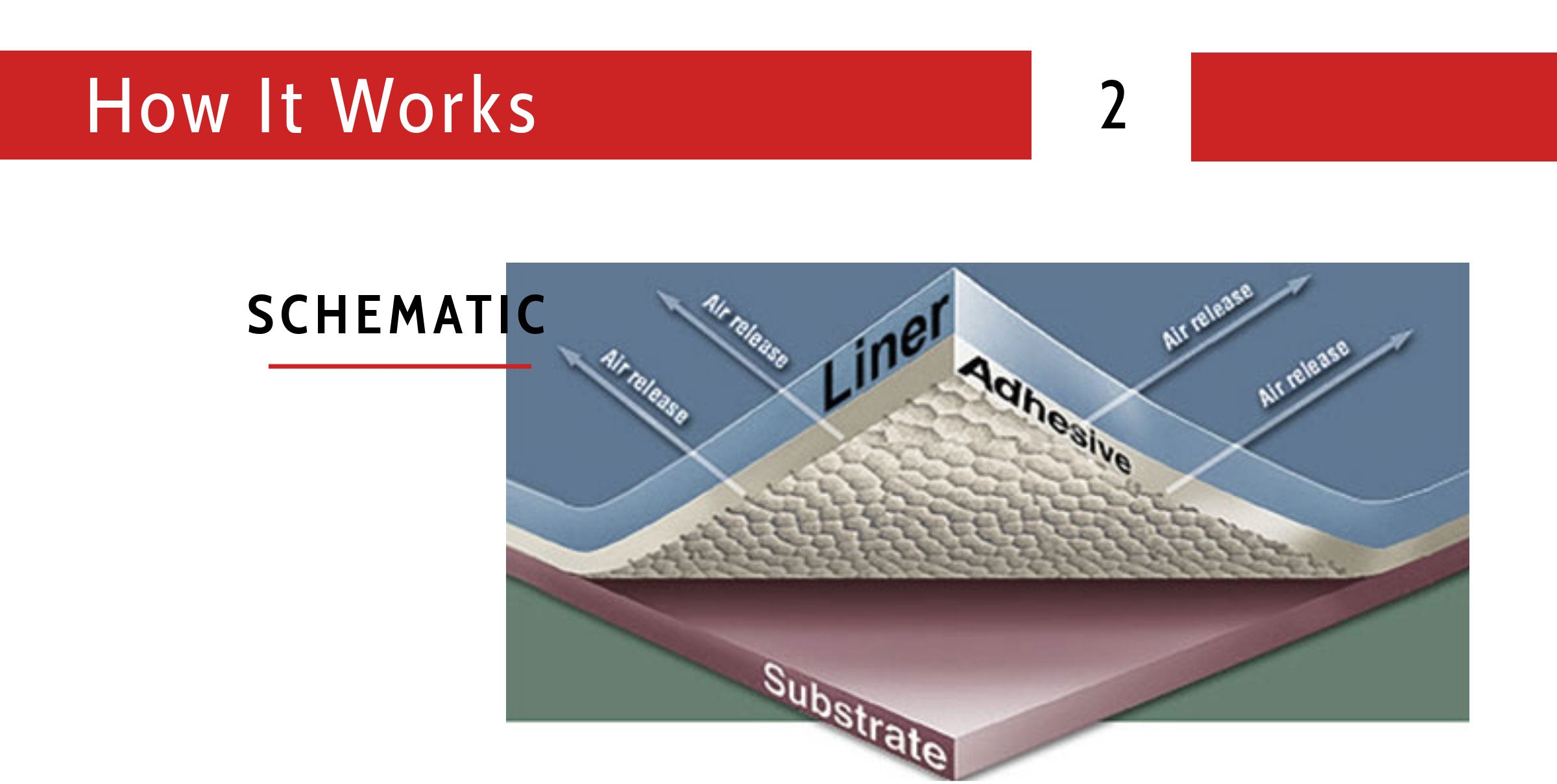

It is my understanding that Slate will be offering a wrap perforated with holes for an easier installation. If that's the case, how will those wraps will hold up over time and what can get past the film barrier. Maybe that's why they are expected to last ~3 years.
The film was described as having "air release channels", this is usually done by adding some texture to the adhesive:
Slate Auto Pickup Truck WRAPS - Handwash only? Air-Release-Adhesive-Vinyl
The air flows through the valleys in the adhesive and out between the smooth substrate.
It's only rated for 3 years because some people will leave their trucks parked in the Arizona sun where the UV will bleach all the colorant out of the plastic.
