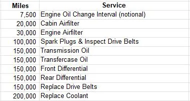

Pet peeve post...
"... or most ICE vehicle related maintenance"
This is the ICEV maintenance schedule for a 2022 Bronco:
We're all pro-DIY right? So, based on 10,000 annual miles driven:
  • one (1) engine oil change every year (DIY - 45 minutes)
  • Engine air filter every 3 years (DIY - 10 minutes)
  • Spark plugs every 10 years (DIY - 4 plugs in my case - 1 hour)
  • Driveline fluids every 15 years (DIY - 3.75 hours)
  • Drive belt every 15 years (DIY - 30 minutes)
  • Coolant at 10 years (DIY - 2 hours)
Not a big commitment. Just sayin'
I understand that’s what Ford publishes as maintenance guidelines, but for any expectation of longevity, I wouldn’t go past 5k for engine oil or 50k for transmission. A bit like keeping charge rates between 20-80% with LMC battery.

I have a '06 BMW. Original owner. Followed BMWs maintenance guidelines. Engine OCI lifetime average is 12,300 miles, manual transmission oil changes just under BMWs 100,000 mile recommendation. Same for the diff, and engine coolant. Just passed 426,000 miles on all the original driveline components, engine included. Component design and chemical properties of fluids are well engineered these days. Jiffy Lube levels of service no longer apply.
Those are really long OCI for a N52 engine assuming that's what your E90 has. BMW guidelines from that era aren't really that good especially with that lifetime automatic transmission fluid stuff they marketed. At 400000+ miles you're definitely due for rod bearings given your OCI.
Modern fluids are good, but the 10k mile OCI is complete nonsense. BMW engines from that era just so happen to take neglect well, especially the venerable M54. The turbo stuff like the N54/55, N20, N63, B48, B58 will all benefit from 5-6k mile OCIs and should definitely not be taken to 10k miles between intervals.
