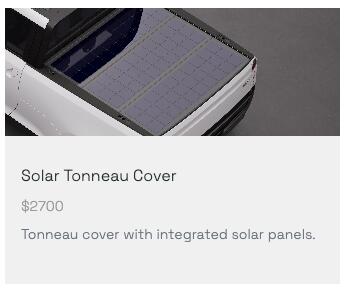

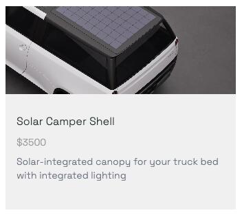

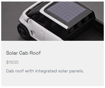

I found these photos on the Telo website. There options would be cool for a Slate although a bit expensive.

If I remember correctly, those are actually made in collaboration with Aptera.

Licensed.
Would like to see Slate license the tech.

LOLZ, $2700 tonneau cover on a truck, definitely need to keep that in the garage to protect it from the weather. Oh... wait.....
