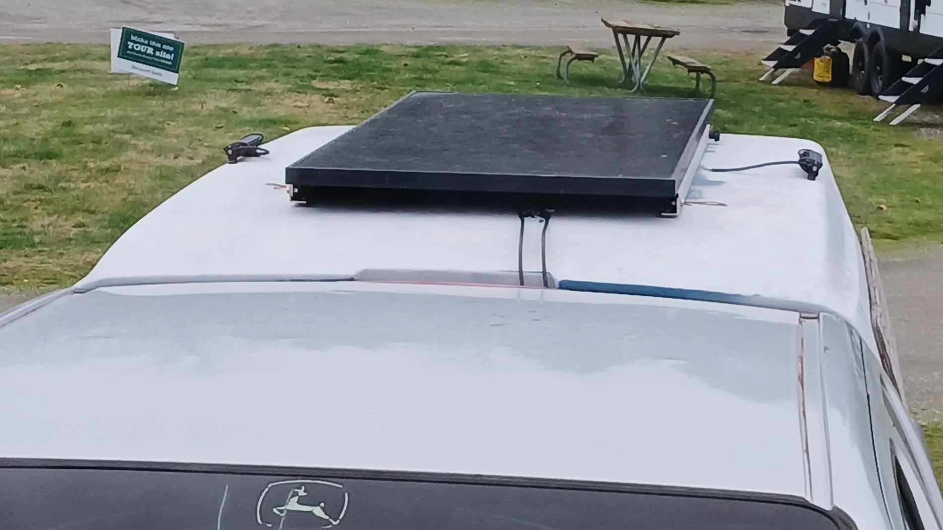

I've had a 200w Panel on the roof of my Nissan for several years.. Just to keep a lithium battery full to run a 55 quart freezer in the back it would be easy to add 500 plus Watts to a slate Fastback cuz that's what I want and all wheel drive
Slate Auto Pickup Truck Aptera-style solar panels in SUV option. 20251121_102051

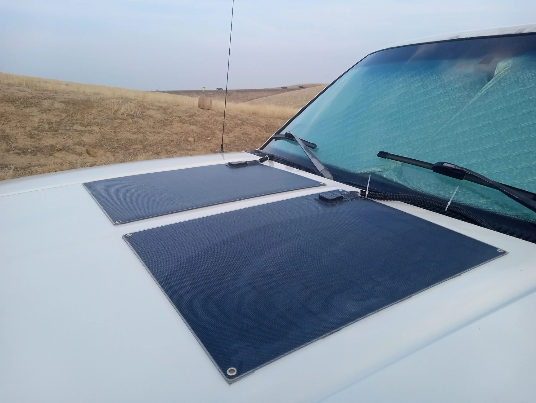

For my camper that is parked out in the field, I have 35/35 on the hood. One to maintain the starter battery, the other to charge a small battery to power USB rodent deterrents. Two panels because of the ridge that goes down the center of the hood. I knew someone in the Suburban camper group who did the same with two higher output panels. For additional power needs, I have a 100w rigid panel mounted on wood frame that is placed on the roof.
The hood panels are from Amazon. Cascadia 4x4 and Lensun make panels that look a whole lot better.

That is awesome I spent all of last year off grid using solar energy only and I was able to run starlink and watch my 50-inch TV and live life normally without having to plug in ever and I don't have a generator
