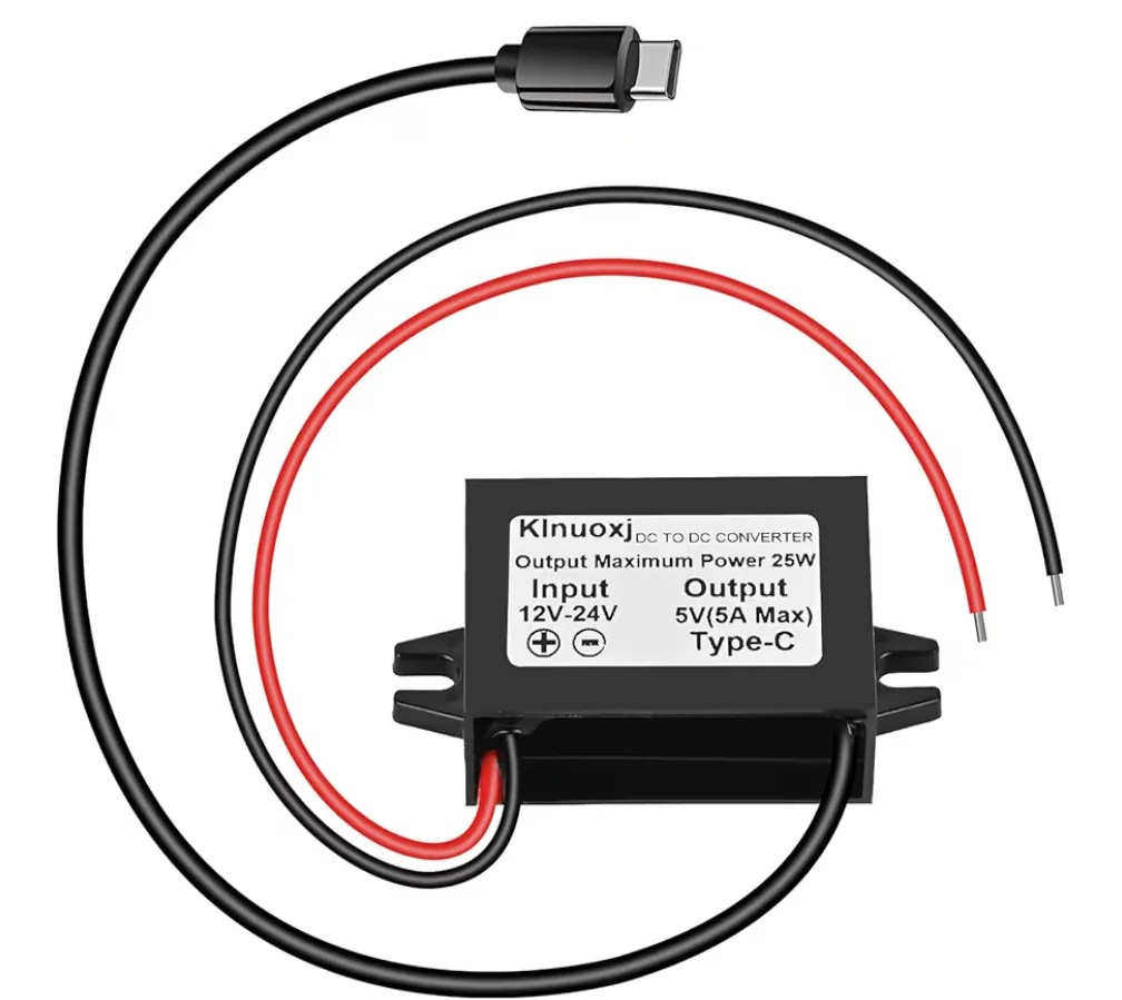

I've found you really have to buy components, the charge pad, power source and the USB cable, test them and put together the wireless charging system yourself.
For example, I have a 2017 vehicle with two USB ports. Plugging a wireless charger into them I get charge speeds around 400mA (checked with the Ampere app for Android). That's too slow. At that rate, going from 70 to 100% takes like two hours or something ridiculous. It's useless.
I've found the best setup is to run 12v to a buck converter like this and plug the charger into it.
Slate Auto Pickup Truck Phone charging - wired or wireless? 1000009032
I've found Lisen Qi chargers work well for me. My phone should work with Qi2 but it constantly connects and reconnects and doesn't really charge with Qi2.
With this buck converter and Qi charger setup, I get a reliable 2000mA charge rate and up to 2500 if I turn it just right. In real world numbers, it's about 1% per minute. The phone gets warm but never hot
I've also added USB ports to my vehicles. I make sure to buy ones with high output. The factory ones just don't cut it. With a USB cable capable of fast charging I can plug a wireless charger into my ports and get similar 2000mA speeds. If you don't want to use a buck convertor, this is a good alternative, you just need to test the USB port and cable.
