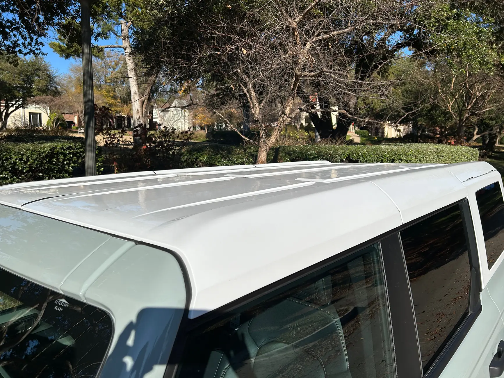

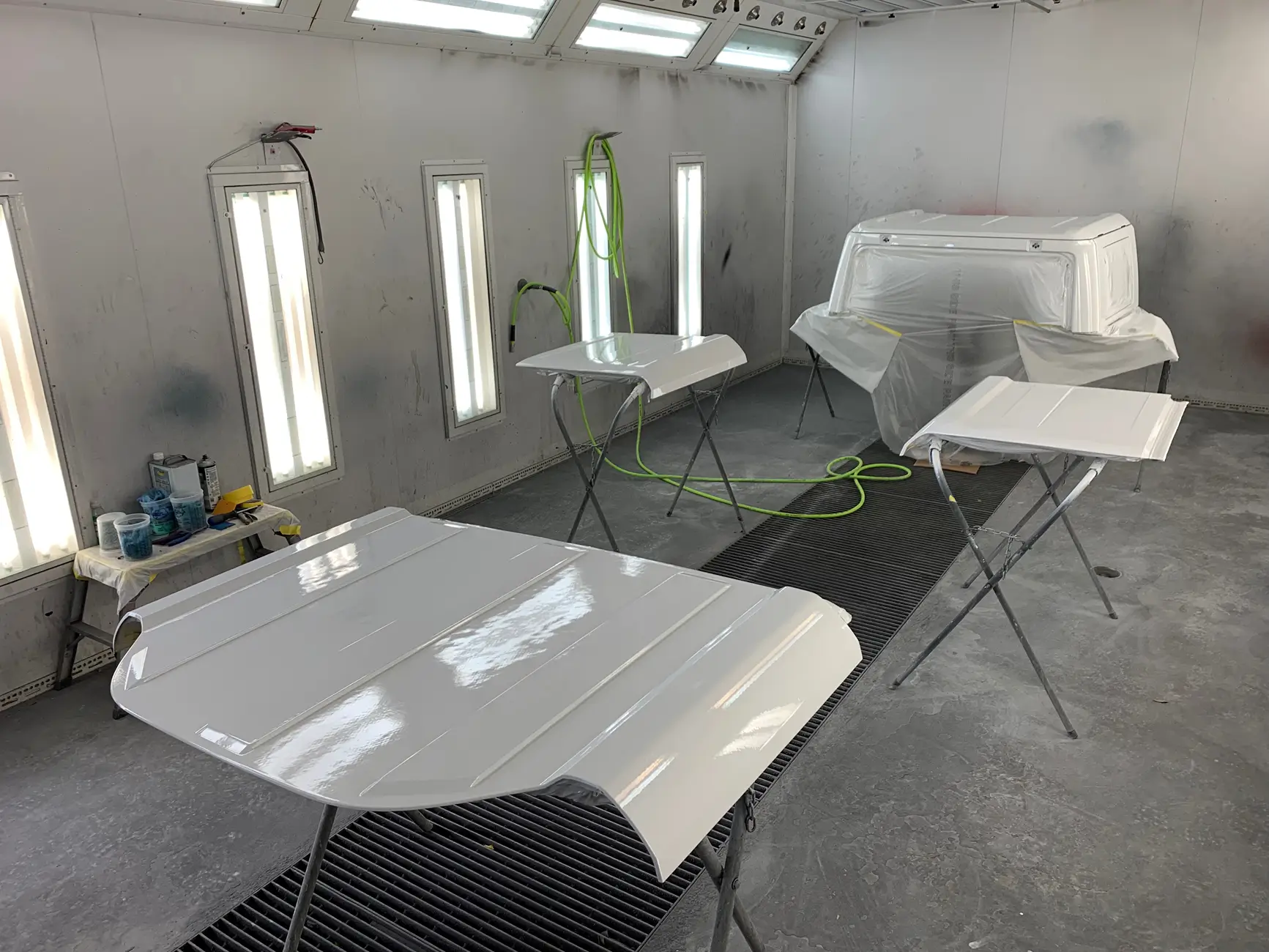

Did some digging and people are painting their molded plastic tops of their broncos, but most everyone who talks about it simply paid a shop for the full job or "dealer was doing it in-house" so I'm not getting any really good leads on it. But at least shows it can be done.
From a thread on Bronco Nation.
Wanted to turn my Badlands into a Heritage Limited- but better. So many places said the top couldnt be wrapped or painted- but my dealer actually has been getting them painted, I think beautifully. Im in Dallas- and Stephen at Tx Prestige Auto is a magician and perfectionist. Its not simple- have to sand, prime, bond and paint- but it can be done. I dont like the Heritage seats and lack of front locker, stay bar disconnect, etc. which my Bronco has. Still have to put the stripes on. Thanks to Bronco Nation timhood for the look and info about the grille and wheels.
Anything can be painted, it's longevity that you have to question. There is a company that paints the mold in black textured Jeep fenders here. Mind you the plastic fender flares on Jeeps and Broncos are painted on some trims as well.
I fell you might be spending a little too much in research on a "solved" issue. The issue is not painting plastic, otherwise there would be no such thing as painted bumpers like there is on basically every car on the road today. The issue is painting a flexible plastic. I would look more into how people are doing paint or if they are all just sticking to wraps on the poly-bumpers getting popular in drifting. They are made to flex and bounce back to keep from constantly blowing up fiberglass or traditional bumpers every time they tap the wall.
