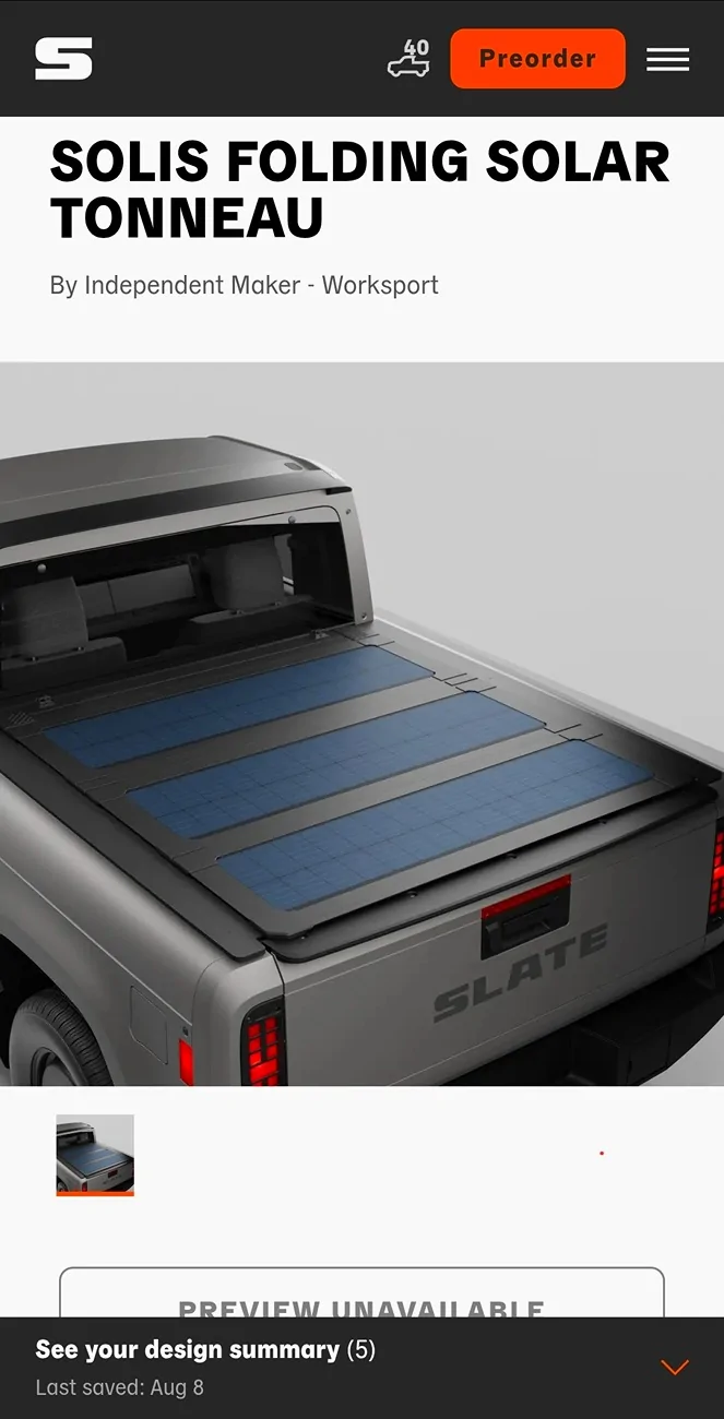

It is in the maker already. $2300
Slate Auto Pickup Truck Solar bed cover panel ? Screenshot_20260811_062743_Chrom

I thought slate had an optional solar bed cover. It's not meant to charge the truck battery
. There is also a solar generator sold separately. It's all kind of pricey, and I'm not sure how much it would help during a work day. I'm going to try solar charging at home , but my system is very small. It would be nice if work places would make metered outlets available to employees, a lot cheaper and easier than bringing your own.

If your truck sat all day in your work parking lot, this panel could help charge the batteries.
I love my home PV system, but the reality of solar is that it's not space efficient. The available Solis tonneau cover has a max output of 300W. Even if that could directly charge the battery (it can't), after efficiency losses you'd be looking at about 1 mile range added for every two hours charging during the peak 6-hour window. If you live close enough to work where 3 miles of added range is actually useful, a bicycle makes more sense than a $2300 solar tonneau cover.

Actually, the panels are only adding $1000 (compared to the non-solar version). Three 100W automotive-grade panels at $333 each is not unreasonable, it's just not a good value if your goal is charging the truck. At $0.50/kWH that $1000 would buy you the DCFC equivalent of 333 weeks (almost 7 years) of workday parking lot solar charging.
However, if you need off-grid power for something like jobsite use, the Solis toneau plus a power bank might make more sense. 300W can charge quite a few DeWalt tool batteries.

$333 for a 100W panel would be outrageously expensive. They're more like $100.
