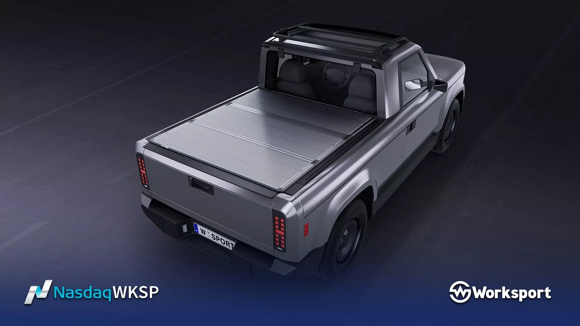

If I could get a polished solution like this, I'd probably HAVE to get one. I want a hard-sided tonneau cover, anyway, so it's a big win to have that serve a dual purpose for harvesting power.

That company has actually released solar tonneau covers for the other trucks they showed, priced at ~$1700 it looks like. Not terrible for a hard tonneau cover, especially one claiming to do ~600W of solar. It's not meant to charge the truck, really, but to charge an external battery/inverter to provide A/C power for camping supplies, tools, etc. For the right person, could be fantastic.
