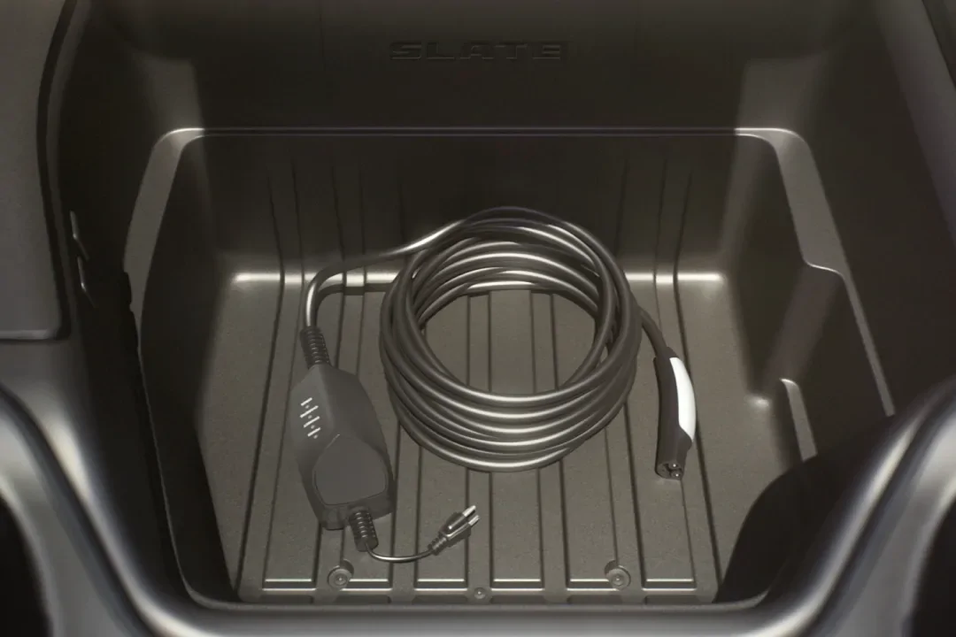

fhats fun, too bad he didn't drill down into the "Current" submenu. Seeing how elementary the "Limit" settings are (100 or 80), I would not expect too much current control.
For Luxrage - I expect the Slates included EVSE to be absolutely the most basic of products with little to no control., especially in 120v mode. There are a wide range of aftermarket EVSE that do offer 120v current control, typically the "2nd tier"- the ones that have a "screen" (really just a LCD/LEC display with a button or two). For example, EVDance brand L1/L2 - it can be set for 6/8/10/12 amps at either 120v or 240v and 16a at 240v only. Its a breathtaking $120 on Amazon. (btw, with "screen" for physical control or with "app" for wifi/app control of current).
editorial: I know many folks will express safety fears with "no name" Chinese branded EVSE's, but I personally have no discomfort at these low current charge rates. I might spring for a more branded experience at 32a and above, as thermals start to be more significant.

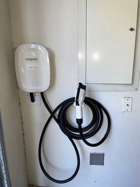

My plan is to install a wired Emporia Level 2, With 40amp breaker. My goal is daytime charging Using surplus PV generated power, preferring not to tax my off grid batteries and never charge at night.
