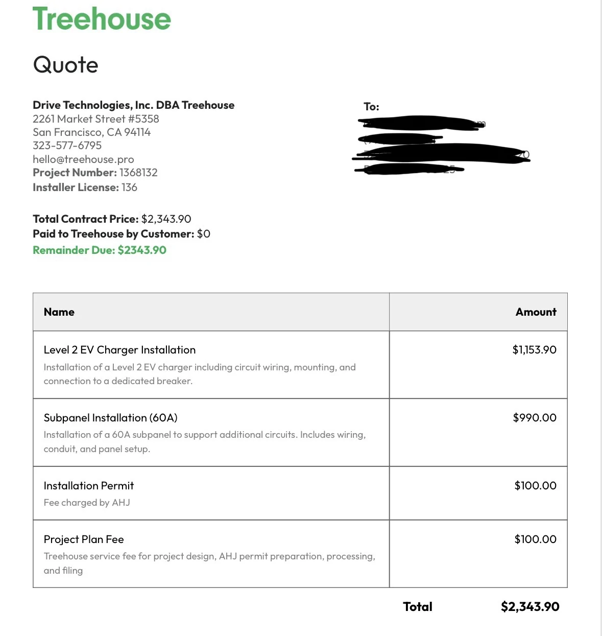

I got a quote from treehouse out of curiosity and it was way too much in my opinion.
Slate Auto Pickup Truck Home charging IMG_7180
They had me fill out a detailed questionnaire and add photos. The charger would’ve gone right next to my panel in the garage. I have unused circuits, but they said my panel was full and was charging me for a subpanel. On top of all that, we already have a level 2 charging station, which I told them in the questionnaire, and all I was asking for was a 240V outlet in case I wanted to plug in the charger that comes with the Slate. They ignored all of that and gave me a quote for a new charger.
If your panel is adjacent to the proposed charger location, here is what you should pay:
Divide item #1 in half. Delete items 2, 3, and 4. Allow about $25 for the standard 50-amp breaker, $25 for the NEMA 14-50 outlet, and like $50 for a length of 6 AWG copper wire. A fair price by a licensed electrician in this case is $750. That is what I paid.
It depends on your length. I priced it out and for 1” EMT, 4x 6 awg conductors (240V plug needs 2 hot, neutral, and ground), 240V 50A GFCI, gangbox, and trim plate was $750 in mats. $2400 seems semi-reasonable. It just depends on where your panel is.

Ah, we just moved out of queens to Rockland in September. The local electrician is definitely not going to charge us that much.
