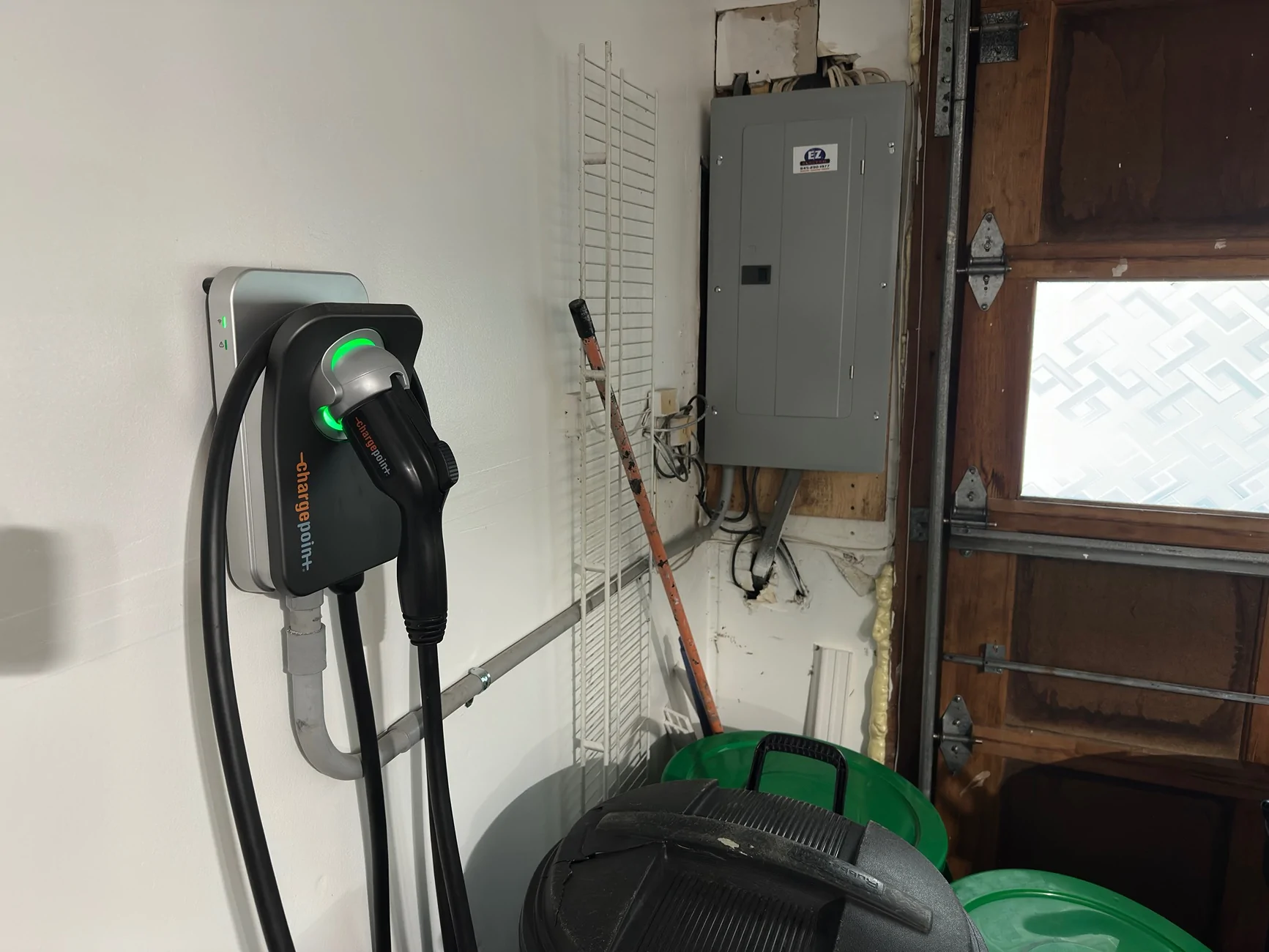

It depends on your length. I priced it out and for 1” EMT, 4x 6 awg conductors (240V plug needs 2 hot, neutral, and ground), 240V 50A GFCI, gangbox, and trim plate was $750 in mats. $2400 seems semi-reasonable. It just depends on where your panel is.
Lol, the panel is literally already in the garage!
I would literally want it right next to the panel. Maybe even one outside on the other side of the wall.

The fuse panel's in the garage, so if the Slate works out I'll probably pay to have a proper 220V line ran from it to the outside of the garage where an exterior charger will be installed. Much like Saint Alban's.
