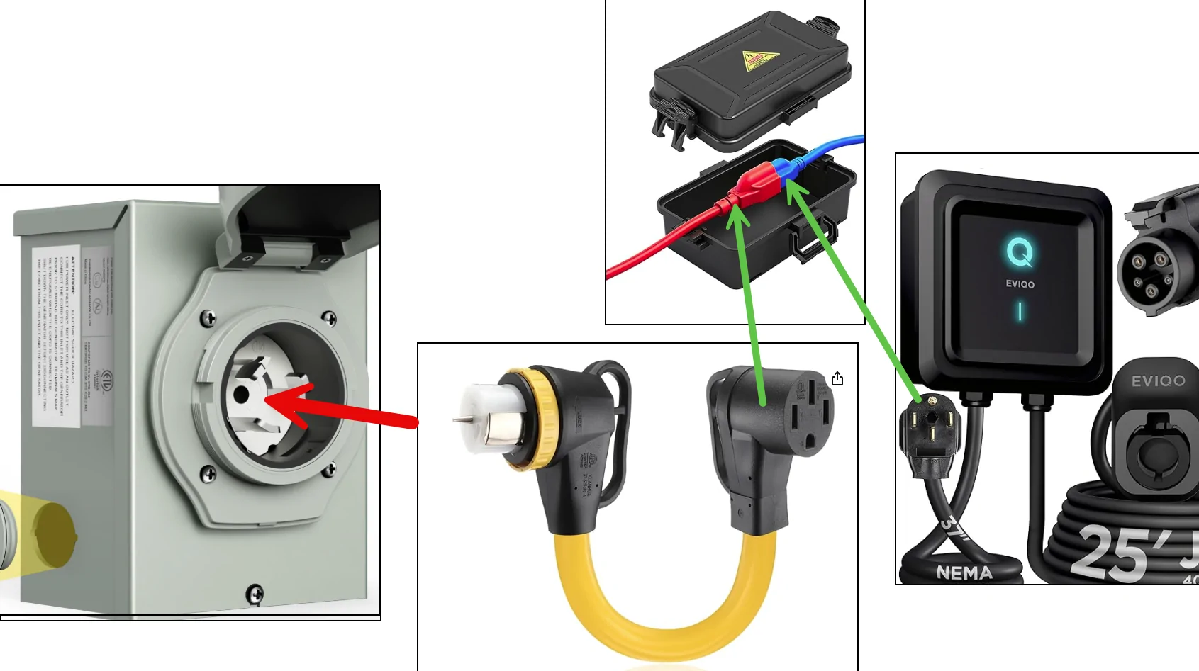

I should be all set.
My home generator outlet on the breaker is 50A. I consulted with my electrician friend. Was told I will be ok, just don't poke my fingers on the metal plugs.
I have a detached garage. It has a sperate 40A panel inside. Electrican told me If I want the charger inside or outside from the garage it will be limited to 30A, which is 24A charging.
I been doing some research. I think 24A will be enough for me. Some of the Level 2 chargers on Amazon I found can set charging currents.
I will give it more thoughts. I need the AWD version of Slate. Got plenty of time to think about.
The liability level your jousting with is epic, Insurance companies check for stuff like this, imagine having a house fire and by saving a couple hundred bucks you get your insurance cancelled on claim for illegal electrical mods..
