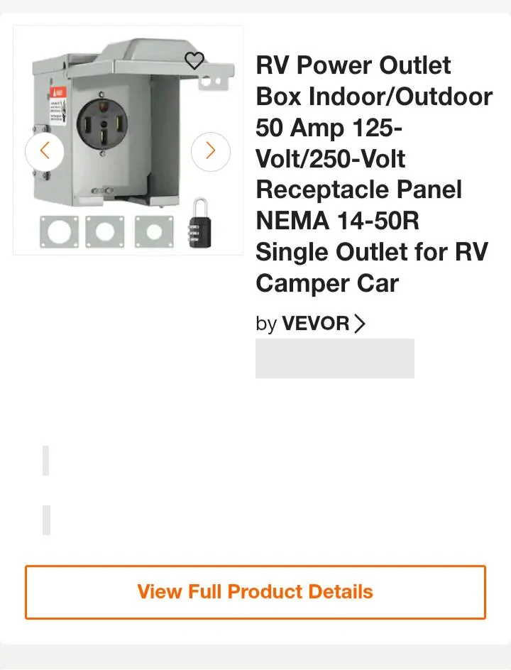

I'm planning on (mostly) charging my Slate from home, and I was going to have a 240V outlet installed in the carport of my mobile home.
Can I spare the expense of a dedicated charger and just have a heavy duty 240V outlet installed?
Also, do I need to check amperage requirements? I live in a mobile home built when disco was king.
Thanks for the education-
That is what we did. We have two EV’s (no more ICE for us) and <15 mile round trip commutes and we just did a 14-50 Nema plug and use the charger that came with one of the cars with its 240 adapter. Can easily recharge from pretty low to full overnight on the rare occasion that’s needed.
I installed myself, but have some electrical training and am a confident DIYer. Make sure to research the products you use. Get the proper breaker to meet code, properly rated wire, and you shouldn’t just use a standard 240 like you’d use in a laundry room, it needs to be industrial or EV rated. Or pay an electrician to install it and make sure they use the proper parts as well.
