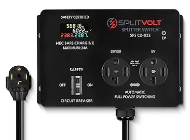

I think the solution for that is a splitter that allows you to share a dryer plug with your EV charger and limits the power draw to something safe.
First step is to replace the outlet with one that is rated for the use. Splitter is only needed if you need the outlet for the dryer.
A dryer only uses power in cycles, switching on and off for up to an hour or so at a time, a charger will use pretty much the max it is programmed for up to 8 hours or more.

Even without a dryer the splitter would still function as a voltage limiter.
The one pictured (just one I found, not necessarily a recommended brand or anything) limits power draw to 24 amps on a 30-amp circuit. That way the charger can't draw more than 80% of the 30 amps no matter how the charger programmed.

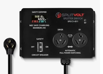

The photo was a "NEMA 10-30" version. Here's a NEMA 14-30 version. Another socket type is NEMA 14-50, which looks like what's on Slate's site.

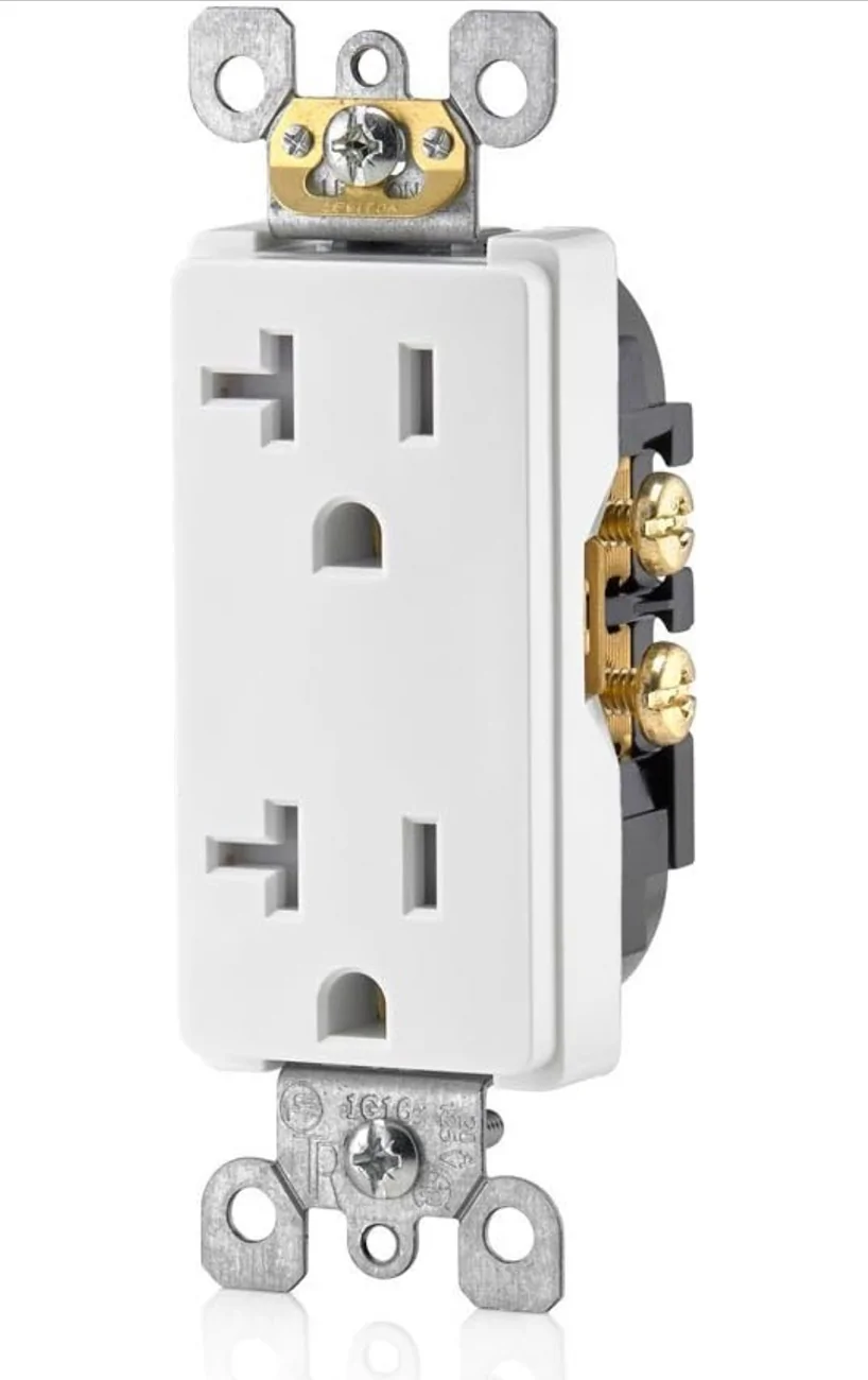

Would this type plug work with the cord Slate shows? This is 120 Volt - 20 Amp. Would this be much of an improvement over the 15 Amp plug? Would that need to use a larger wire and larger circuit breaker? If you could get 17 Amp would that even be much different than 12, enough to notice?

How does the Dryer Splitter switch work?When the dryer quits, the car starts charging?
I think so. The automatic ("smart") splitters prioritize power to the dryer outlet when the dryer is in use, and send power to the EV outlet when the dryer is off.

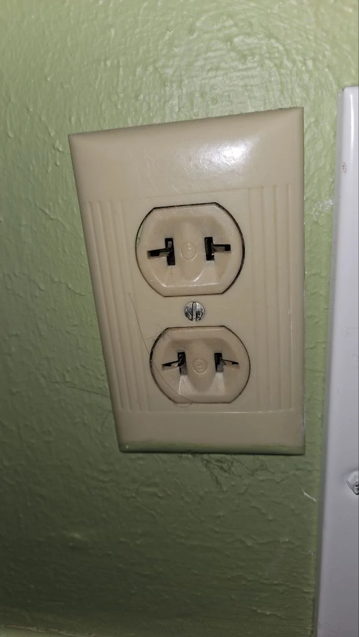

My house is entirely wired up with 20A circuits for some reason (Built in 1970), and for these kind of outlets they use 12 gauge wire instead of 14 and they're all 20A breakers. So you'd at least have a slightly beefier cable and breaker for it. I think the nominal continuous current draw would be something like 16A for it instead of 12-13A for a regular home outlet. There might be some efficiency losses doing it 120V instead of 240V though.
Edit: the weird outlets the house had
