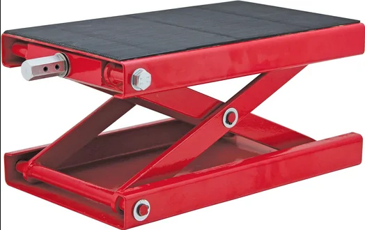

I have no idea how it's done, but I can make stuff up.
This motorcycle jack is rated for 2,000 lbs.
Slate Auto Pickup Truck Will Slate Make Their Battery ‘Easily’ Replacable? Motorcycel_Jack
Put the truck on a lift. Don't lift it yet.
Slide that jack under the truck.
Raise it until it touches the battery.
Unfasten whatever fastens the battery to the chassis.
Lift the truck.

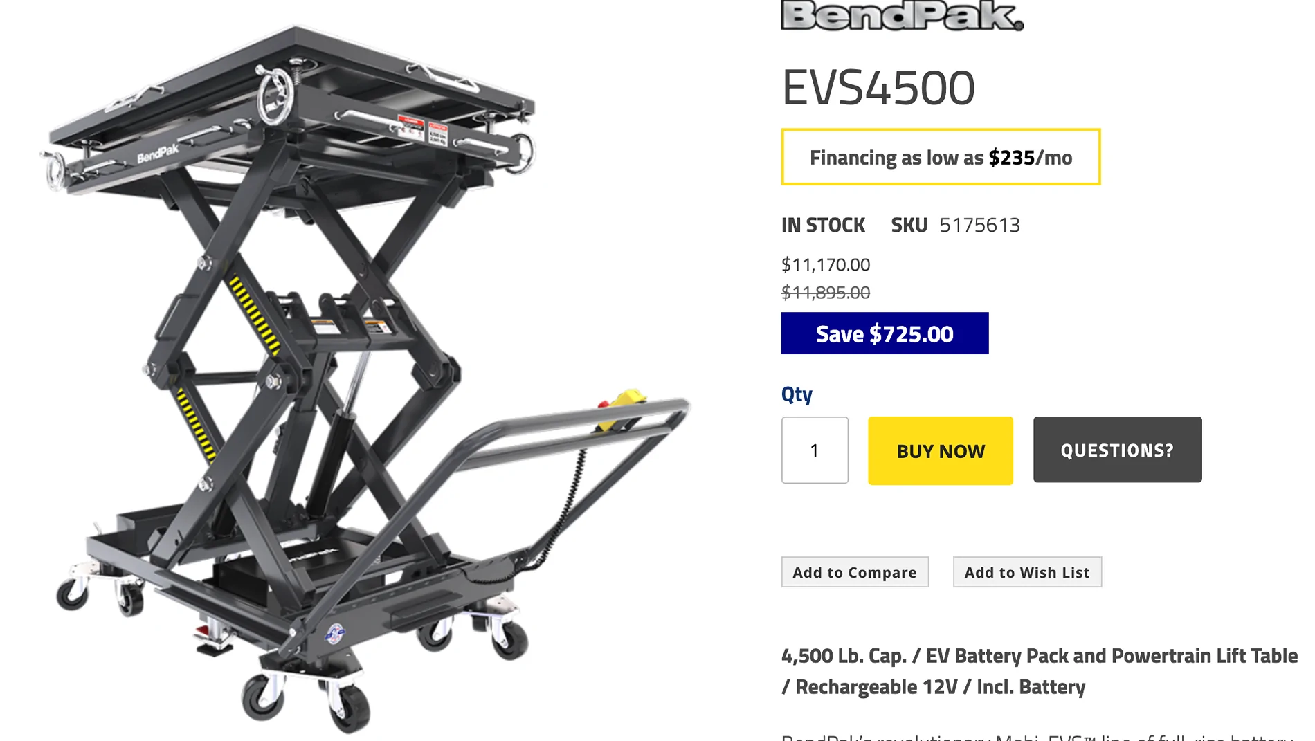

The "official" way to do it is with one of these portable battery lifts: https://www.bendpak.com/car-lifts/ev-battery-lift-tables/
Only $11k!

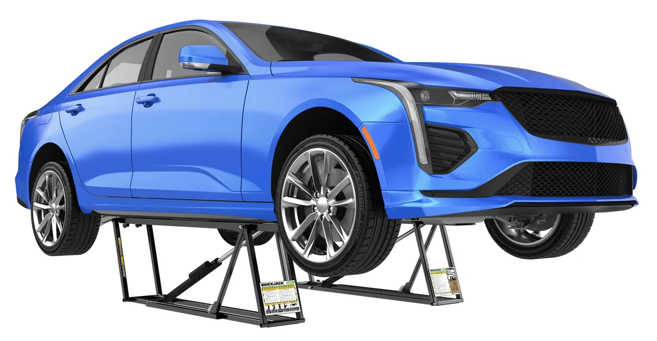

Now, with some care, you might be able to make one of these Quick Jacks work. They are popular, and while not cheap ($2k or so), they are cheap enough for an enthusiast to get a lot of use out of, especially if you are maintaining multiple vehicles. https://www.quickjack.com/category/portable-car-lifts
Slate Auto Pickup Truck Will Slate Make Their Battery ‘Easily’ Replacable? 1767761197219-zj
I'd imagine in this case that you'd lift the truck with the quick jack, support it on stands, then drop the jacks and move them under the battery support rails and apply some lift to it. Remove all of the fasteners and connectors, and lower the battery out. Only part I'm not sure of at that point is how you get it out from under the truck...
Only $11k!
Repurposing quickjacks like that is definitely doable. I have the older version before the TLX series came out and the only shortcoming I can think of is the short height. They only go up to about 2ft. I guess for a home diyer it could work.

Internet Rando here...
Lift the truck.
Just asking, but then how do you get the old battery off that jack, and put the upgrade battery on the jack at the precise orientation and then slide it back under the Slate (or roll the Slate over top of the jack)...?
Only $11k!

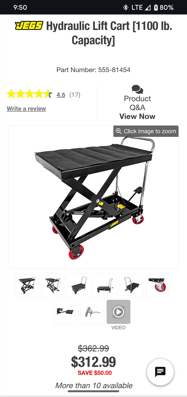

There's definitely cheaper lift table options, haha.
That's a nice one, but it won't support the weight of one of these batteries. It might just barely cover the SR battery, but the ER battery will be over 1000 lbs.
Yeah, I've seen 1500lb and 2000lb versions that aren't crazy expensive. That $11k table has adjustments built in to make the fine tweeks to make lining up a battery easier, but to do it once or twice a sub$1k table would be fine.
