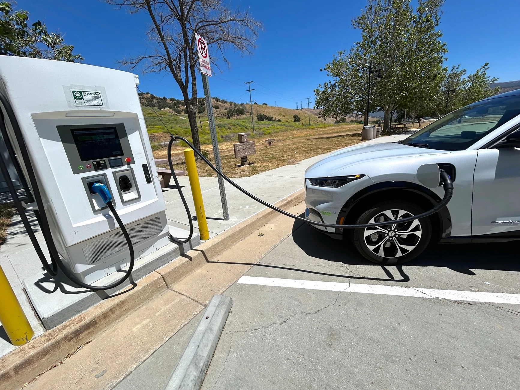

As for my Ford BEV, I get around 3 mi/kWh around town / commute / low speed driving.
However at high speeds over 60 MPH, it drops to 2 mi/kWh.
Then add cold weather and it drops even more.
Where I live in warm sunny all year around weather, when I drove to Northern California recently on my monthly road trip, efficiency took a hit due to colder temps (40-50 degrees) and had to stop at an extra charging location along the way, compared to summer travel.
FREE 72kWh DCFC at CA DOT rest stop:
Slate Auto Pickup Truck Slate Extended Range Battery - Price? IMG_2174
