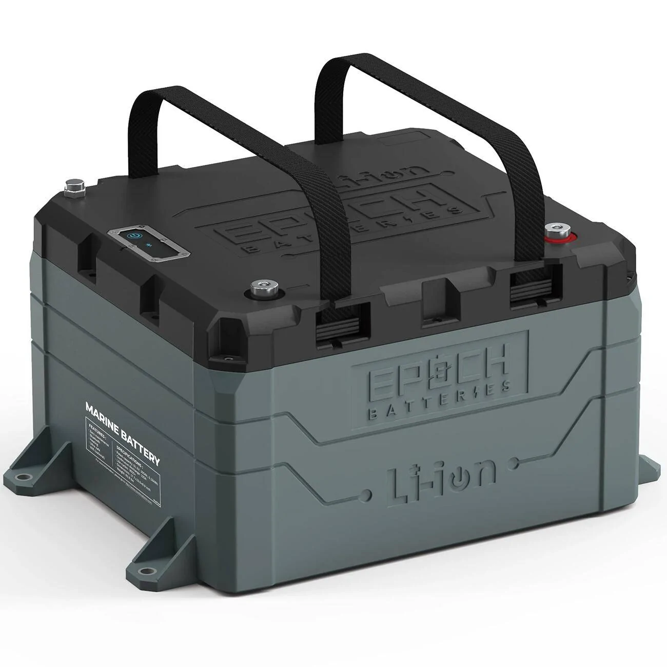

The Apex 300 has a lot of things going for it, but it's probably not going to be the one I'll be installing in the Slate. I'm more inclined to go with system that will be bolted in or bolted down when it comes to the batteries and related electronics. I'd like to take advantage of the Slate's generously proportioned frunk to store some of this stuff. If I'm planning on keeping the entire solar system attached to the vehicle and knowing in advance that I'll be dealing with LFP, those batteries will need to be heated. I'd also like a certain amount of waterproofing.
Exact detailed yet to be determined, but the mental picture I'm currently drawing up would probably work around two or more of these sort of marine grade heated LFP packs . . .
https://www.epochbatteries.com/products/48v-50ah-heated-bluetooth-lifepo4-battery

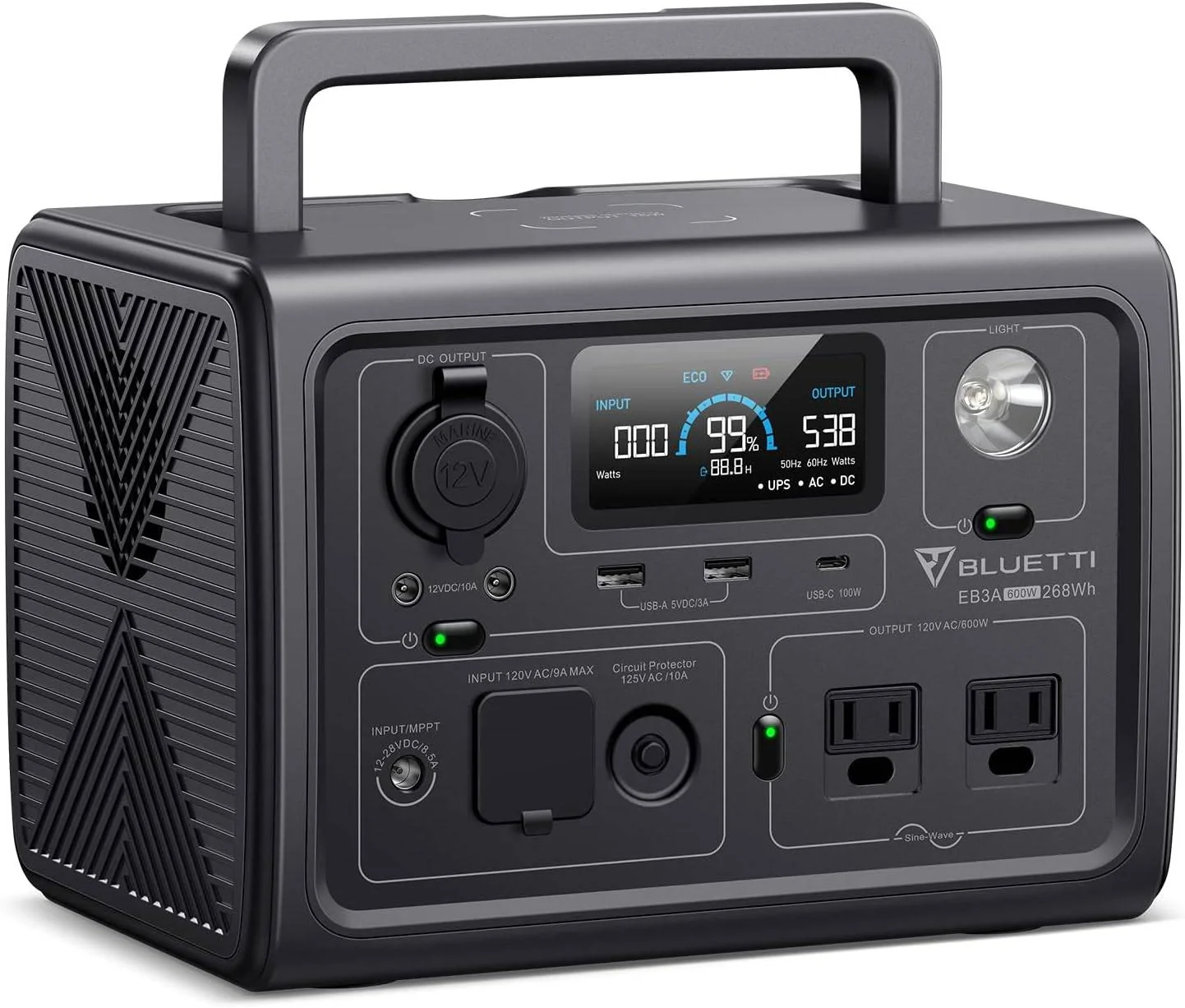

All these companies -Bluetti, Ecoflow, Jackery, Anker, Pecron, DJI, etc. - have extensive product lines and make these solar generators in a bewildering assortment of sizes and styles. They also refresh their product lines fairly regularly and bring new ones to the market all the time.
The Apex 300 is notable in that it's the first, apparently, to require an add-on box to access DC output. I guess they figure that a unit weighing 84 pounds with 240VAC capability is going to mostly live near a house's service panel and that someone needing charge their cell phone is probably going to be wanting do that in the living room or bedroom.
For the interior of the Slate, find a smaller solar generator to keep your phone, tablet or laptop charged. I have a couple of these that I freely move around the house to wherever I need them . . .
Slate Auto Pickup Truck PSA: Extended Range Battery can NOT be added / retrofit installed after purchase (confirmed by Slate) EB3A_01
The Bluetti EB3A is actually 3 years old now and, while I think they still offer it, it's been largely superceded in their product line by at least a couple of similarly-sized ones with slightly different features and other refinements. The competitors all offer their own versions in this carry-around size class. What you'll find is a different assortment of USB plugs, 12V interfaces and varying strengths on the inverter's AC output.
You could have something like this on the seat or floor next to you in the Slate. Or maybe there's already one that's porportioned perfectly to fit into the Slate's dashboard cavity. Hmmm . . .
Benjamin, thanks for all the info in this post! Lots to think about and further research.
Have you had good experiences with Epoch Batteries?

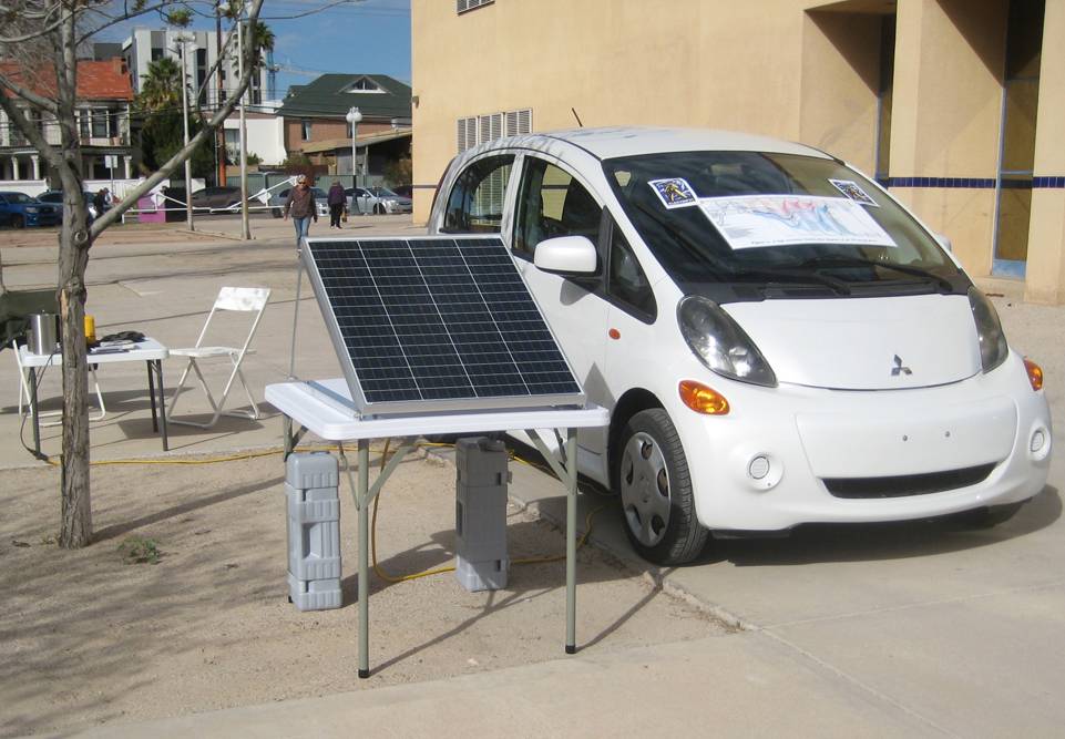

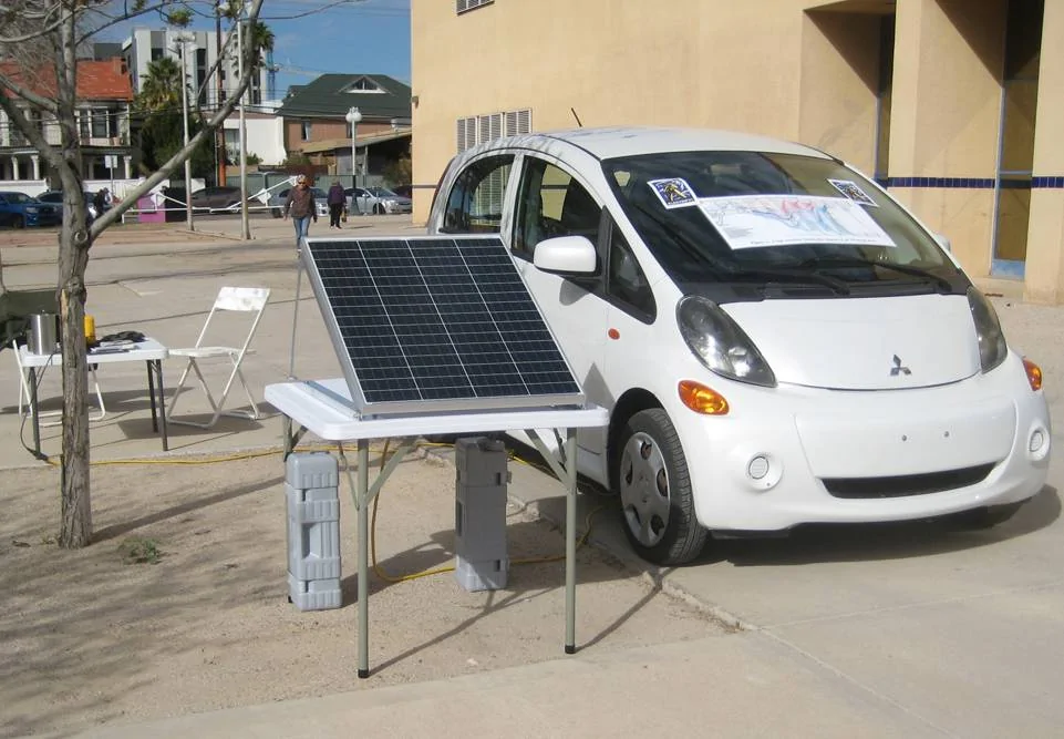

Photo attached showing the i-MiEV next to a table-mounted 100W PV panel. There's an EB3A or two hiding in there someplace.
