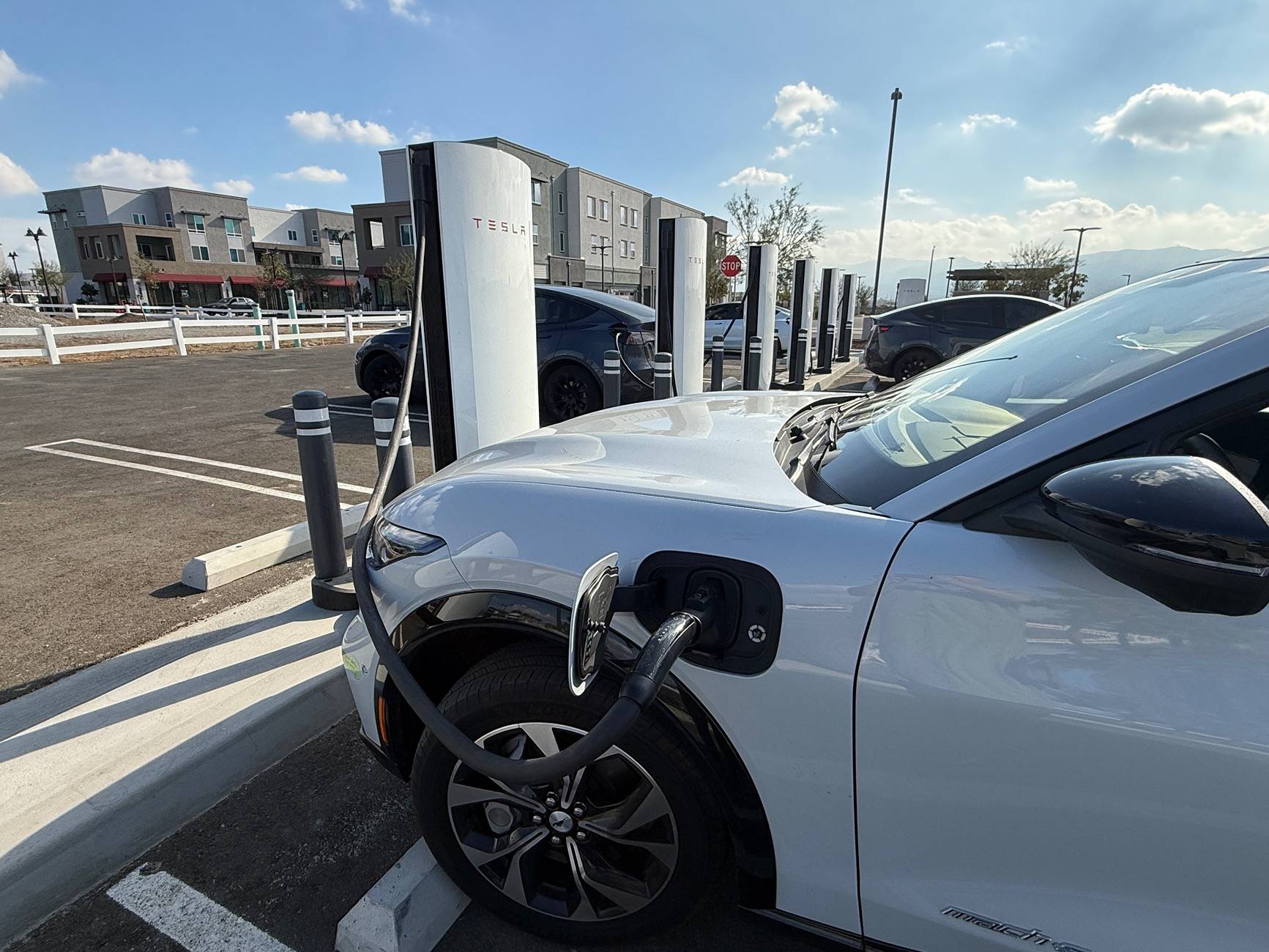

You do know that there are Tesla Superchargers on the island of Hawaii ?
We rented a Tesla from the airport and charged a lot at Tesla Superchargers at
5000 Kahala Avenue in Honolulu.
Hoping Slate will arrange access to Tesla Superchargers as that will be my main reason to get one.
For my Ford EV, I always charge at Tesla due to the lower rate I pay as a member.

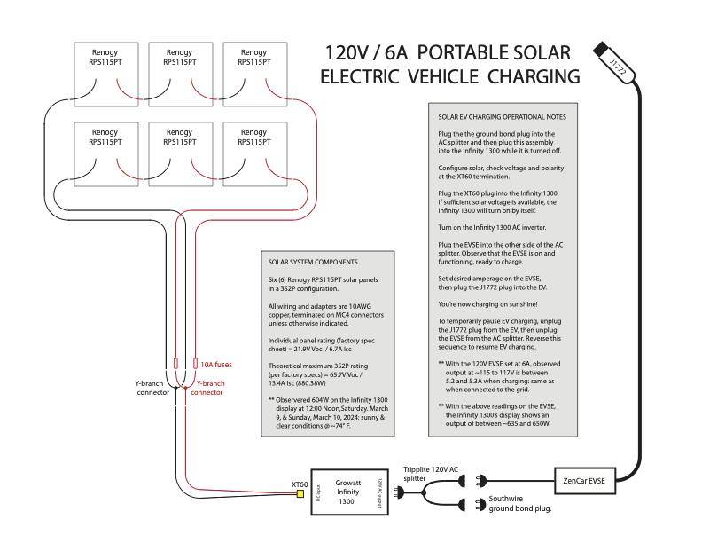

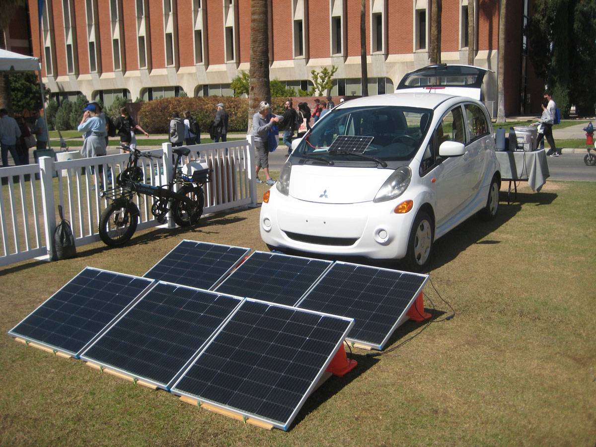

Solar panels mounted on the Slate? Yes, we're reading each other's minds. There are lots of different ways that something like this could play out. Certainly more than could be put into a single post. I'll start with detailing how to charge the i-MiEV with (relatively) portable off-grid solar on a budget.
Slate Auto Pickup Truck PSA: Extended Range Battery can NOT be added / retrofit installed after purchase (confirmed by Slate) TFOB24_01_W
Slate Auto Pickup Truck PSA: Extended Range Battery can NOT be added / retrofit installed after purchase (confirmed by Slate) Solar_configuration_01
The photo shows the i-MiEV at the March 2024 Tucson Festival of Books in the Science City display area. The idea I was demonstrating was basically how I could bring everything I needed in back of the car, set it up without electrocuting myself and actually make it work. The illustration provides the technical details.
Briefly, I was bringing in roughly 600W via the 6 PV panels, using a Growatt Infinity 1300 MPPT/battery/inverter interface (ie: power station, solar generator, what have you) and outputting that same ~6 amps as 120V alternating current that the EVSE would recognize, pumping that into the car.
As long as the Sun is shining brightly, I can maintain that roughly 1-to-1 input-to-output ratio for around 5 to 6 hours. As soon as the Sun sets, the approximately 1.3kWh in the Growatt's battery keeps the electrical flow going into the car for another couple of hours. Optimistically, it would probably take a couple of bright sunny days in succession to charge the i-MiEV's 16kWh from near empty to near full.
One limiting factor on these small power stations (or solar generators, as I like to call them) is the maximum amount of voltage that can be accepted at the DC/MPPT input. The medium-sized ones might only be able to handle 60V. I picked the Growatt because is was relatively compact, not too heavy (around 40 pounds,) and could accept up to 100V DC.
If you wire 3 of these 115W Renogy bifacial panels like I'm using here together in series, you might get anywhere between 60 to 75V. But 4 panels configured this way might push you too close to the Growatt's 100V threshold. At best, you'd be tripping the breaker constantly and interrupting electrical flow before everything (hopefully) resets automatically. At worst, it's possible to burn up the MPPT's circuitry.
The other electrical consideration is that these solar generators have a floating ground and simply plugging in the EVSE on the AC output side will indicate a ground fault, prevening you from charging your car. A simple combination of a splitter cable and a ground bonding plug "tricks" the EVSE into thinking it's plugged into a standard grid-connected grounded receptical.
I've got 10 of these Renogy panels and now have a more suitable solar generator: a Bluetti AC200L, which allows up to 145V on the MPPT input side and a battery that around 2kWh in capacity. To speed things up, I can configure 5 panels in series on 2 parallel strings (5S2P) for a realistic 1kW input/output. I can then set the EVSE to 8 or even 10 amps, speeding up the EV charging sequence considerably.
Lots more to say about solar charging an EV. I've watched closely what Aptera, Sono and Lightyear have been doing to fully integrate it into the car itself . . . and I'm a big fan. An off-grid solar carport charging a standard EV is what I've reproduced with my portable experiments, but on a smaller scale. And anyone with grid-tied rooftop solar (I'm in that club now) can essentially charge off the Sun, simply by plugging the EVSE into any standard 120V receptical on a sunny day.
And, yes, I've got lots of ideas on how one can turn a Slate EV Truck into a relatively powerful portable solar generator on wheels, complete with easily deployable PV panels, capable of patching into a house's service panel to provide emergency home backup power for extended periods, or simply being able to bring sustainable and self-generating electricity to just about any unshaded place you can park.
Anything I would be doing along these lines, for sake of economy and not wanting to challenge the vehicle's electrical system warranty. It would involve building an autonomous system with separate batteries that doesn't directly integrate with the truck's traction battery. I can't, for instance, charge from the PV panels mounted on the vehicle while driving (like the Aptera, etc.) But I can park, deploy the panels and charge the vehicle while stationary.
More to come on this wide ranging topic . . .

Really good stuff. People reading should be aware that wiring solar panels in series makes the voltage additive while doing it in parallel makes the current (amperage) additive. The higher the current, the thicker the cables need to be to handle the heat. Typically, LFP power stations like more voltage to generate more charging power (watts) rather than more current. It is a known problem amongst overlanders that trying to charge power stations off a vehicle alternator without some form of voltage step up converter is a recipe for frustration. Just way too slow.
I could easily see having a solar generator trailer (less than 1000 pounds) to drag around behind a Slate. Park it in the sun, deploy the PV panels, and plug the AC output into the Slate charging port (with appropriate grounding). I might even put AT tires and a RTT on it and take it camping.

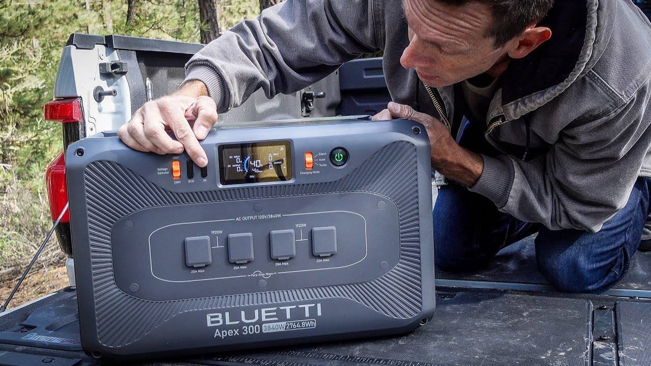

Excellent stuff and meshes with my thinking. I can learn a lot from you.
taken from my email to Bluetti:
I am completely off grid, more traditional, old style Outback solar system.
4 PV arrays approx 4.4 kw each, fixed orientation
4 FM80 charge controllers
2 GS 8048 Radian inverters
57 Kw LiFePo battery bank
No microinverters
No grid
Not a 500VDC system, 48VDC
Ideally I’d like to charge from 1 of my PV array, either by diversion, or preferably share to utilize excess production. This would be daytime, sun-shining only. Probably average 5+ hours. Level 1 initially, Level 2 at some point. This would be more top off charging than full on everyday type. Might be possible to split off 2400w, have to look. Would not be looking at the 500v.
I do NOT want to use my Inverters or tap into my battery bank. Basically, other than the PV, keep my house system separate. Sounds like another alternative might be install 2400 PV separately.
It appears i can do so with your Apex 300. Perhaps a new adventure, I’d love to see this direct DC to DC charging bypassing the battery, but don’t see that product exists, but would be a good market. Need a beta tester?
Secondarily, I see your system is available bundled with own 200 PV for charging. This suggests to me I’d be able to drive my Slate across island and recharge as it sits in the Costco parking lot 2 hours. How many kwh? Very sunny in Kailua Kona. I can see that benefit enhanced with roof mounted PV.
awaiting their response
I should add, you sound much more technically capable than me 😁 Ilike the idea of the Apex 300 being 240 capable. At first I didn’t realize the battery was separate, but makes sense I guess and some flexibility.
