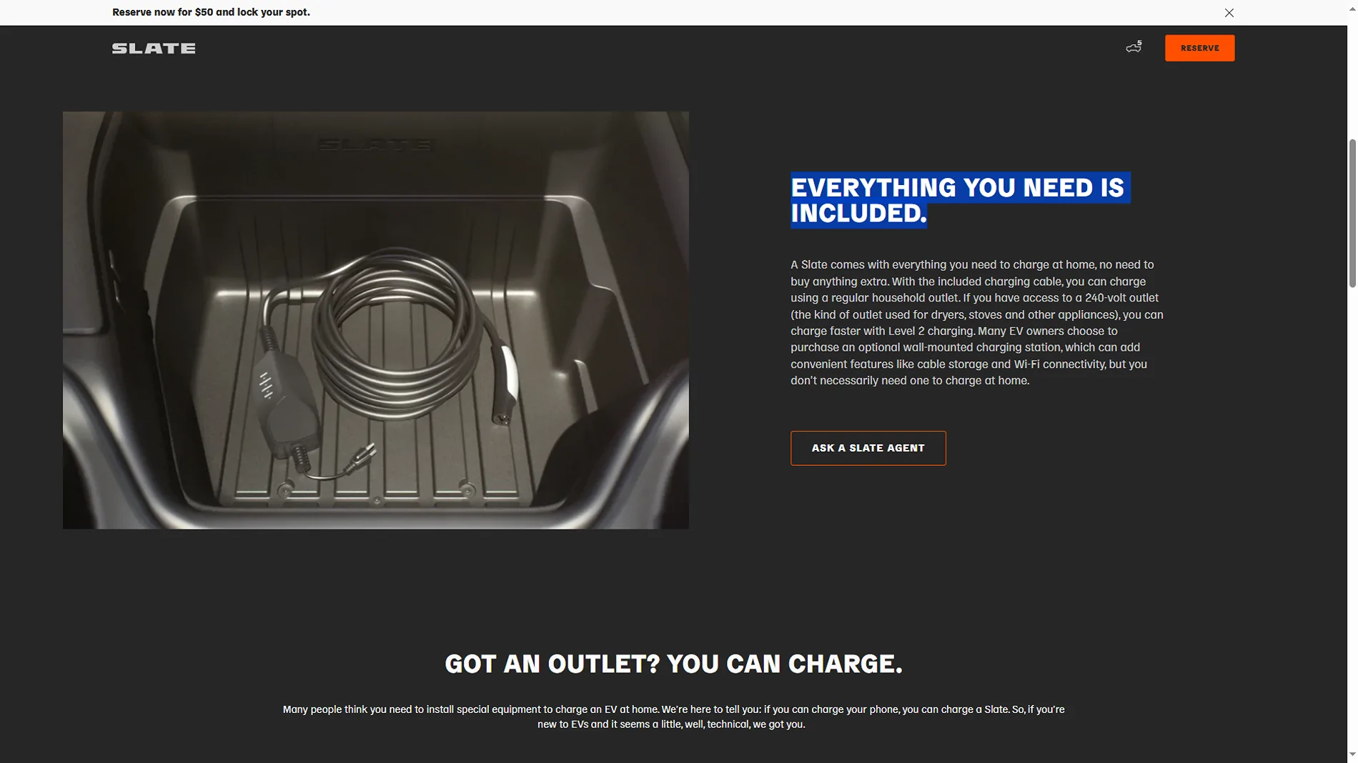

That's a great deal, but I thought the Slate truck comes with a Level 2 charger. All you need is to do is plug it into a NEMA 14-50 240 V dedicated outlet. But I agree Wi-Fi access is a desirable option. I wonder if the supplied charger has Wi-Fi access.

I'm a bit wary about it. It appears to be the Lectron unit listed on their website, which they state is only a level 1. Even if it is a combined level 1/level 2 charger, I'll still keep it in the truck as a backup. The home unit is hardwired, which is a much better option in my opinion.

I was wondering about the charge cord Slate shows and says is included. It only has a 120 volt plug. Is there another 240 volt plug that is also included but not shown? Maybe an end you can change but not shown. You can't get level 2 charging from 120 volt, correct? Slate says everything is included for level 1 and level 2 charging. I am new to EVs and just try to read all I can to try to understand.

That picture of the charger in the frunk may just be a 'rendering' of the kind of charger we will get. Slate Auto has stated you will get everything you need for both Level 1 and Level 2 charging. I will hold them to that statement. Maybe we need to reach out to Slate for clarity.

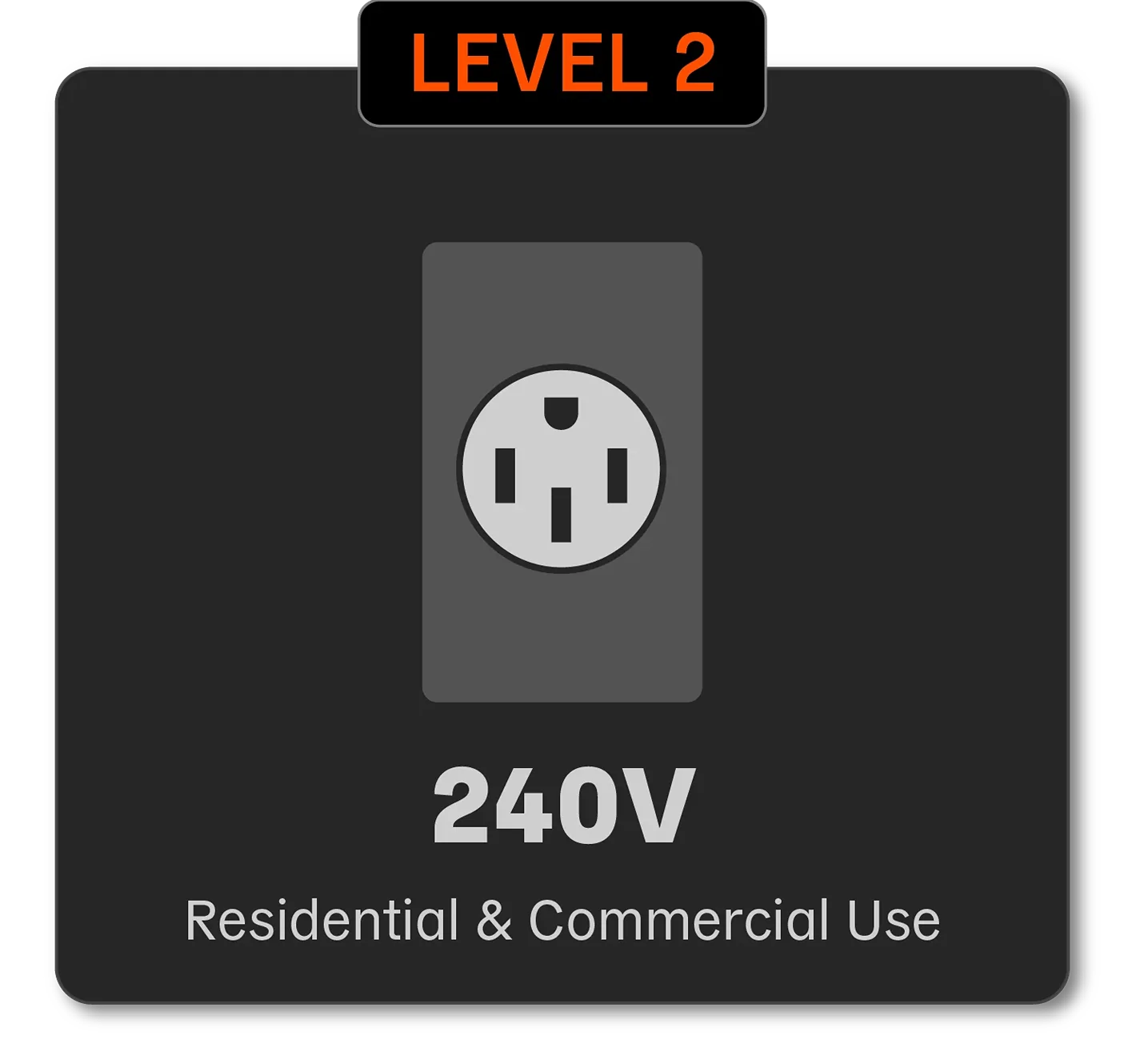

Looks like it’s a separate cable.
LEVEL 2 – APPLIANCE OUTLET
Use the included Slate charging cable • No need to purchase extras • Adds 25 to 40 miles per hour of charge • Full charge in 4-8 hours

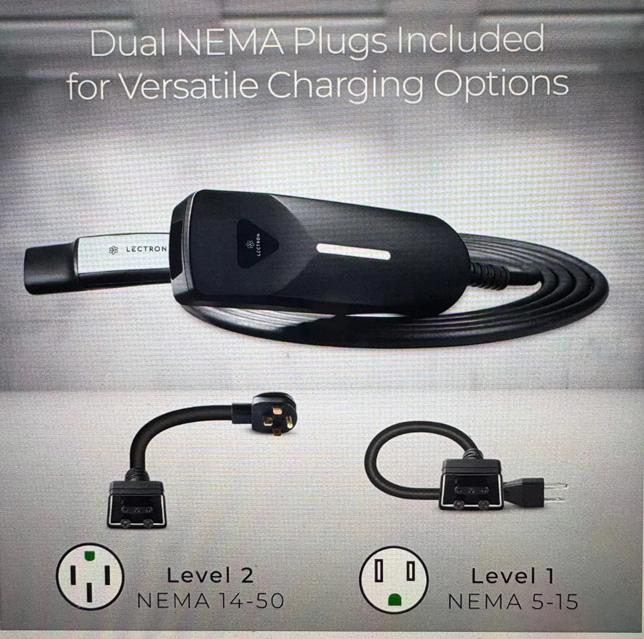

Chevy bolt euv came with a single charge cable but with 2 pigtails.. one for 120v level 1 plug and one with a 220 plug for level 2. Swapping the plug and play pigtails on the charge cable let you have both options. The car and charge cable are smart enough to configure based on the voltage you’ve plugged into.
