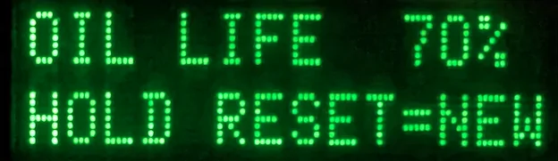

Using the dashboard display and steering wheel buttons for that (and for scheduling) would make a lot of sense.

What I'm saying is it cold be trivially easy to set a max-SOC parameter using the steering wheel buttons and dashboard display.
Similar capability has existed in cars since at least two decades ago.
