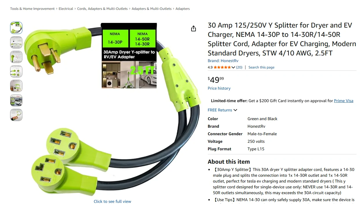

I was thinking something like this that would allow me to plug the dryer back in, and run an extension cord outside for the EV. I know it's archaic, but I don't anticipate needing to do it very often (if ever). I don't drive very often so my 110v in the shop will probably do just fine.
extension cord is the problem.... 240v @ 30a is not really an approved thing.
but no worries, as you say, your existing garage power will be fine, you'll figure out how to manage it.
Be careful buying electrical devices off Amazon, and make sure they are UL listed for the task. A LOT of the stuff on Amazon is not UL listed and 'complies with' any UL standard doesn't count.

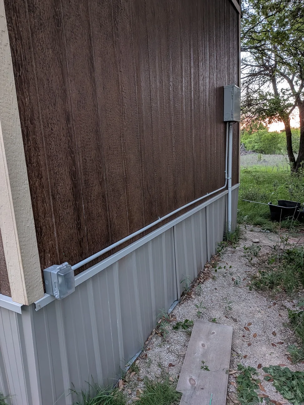

Here's what I did on my daughter's cabin. That's a NEMA 6-20 (240v 20a) outlet under the weather resistant cover. It wouldn't be much harder to do a similar thing inside a garage if your breaker box is in there.
Her Level 2 charger has a right angle plug on it so it can stay plugged in all the time and be protected from the weather. Something to keep an eye on when choosing a level 1 charger.

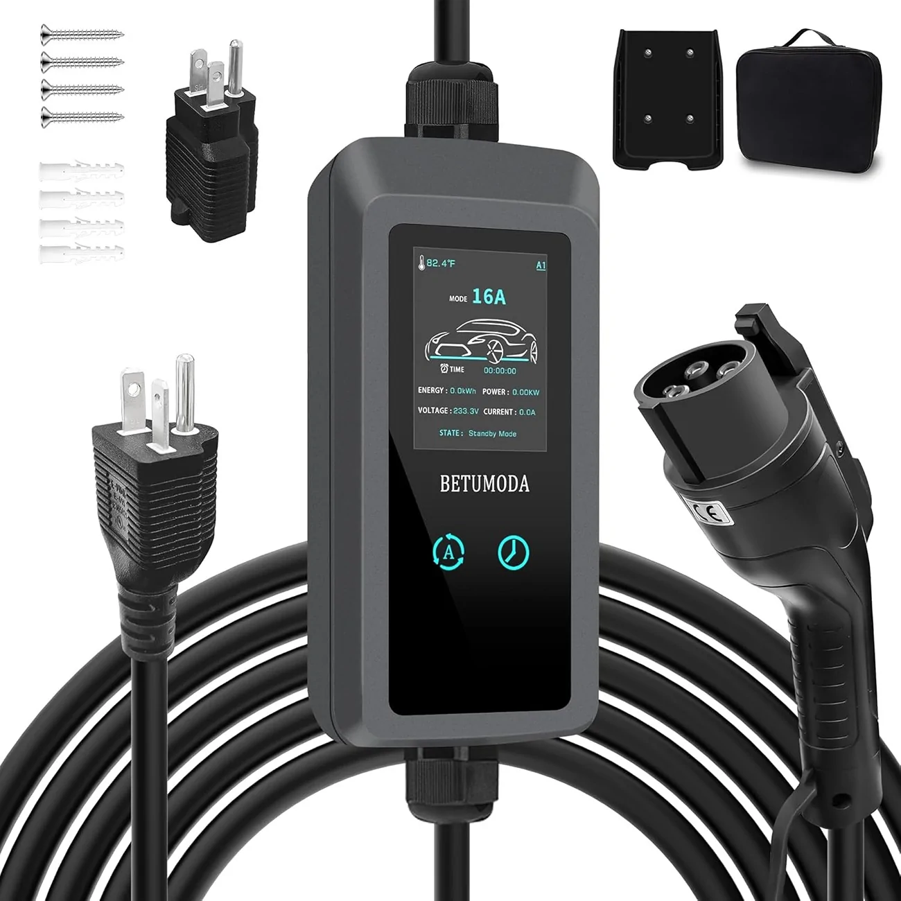

A lot of them have straight plugs and are not friendly to use in a semi-permanent way like this. Gravity tends to bend them down ... especially if you're plugging into a 110v outlet with the adaptor/extension like this one shows:
Boom ! perfect illustration of a practical approach. Obviously you had a subpanel handy nearby, and I assume there was greater then 20a capacity there, ya?
Was the choice of 20a merely a budgetary/no need for more thing, or was there another actual constraint?
