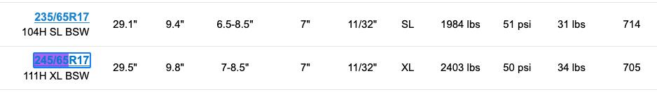

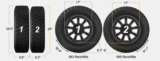

Could dropping tire size slightly to 235/65R17 help liven things up a bit?
  • Lower unsprung mass (three pounds?)
  • Less rotating mass (and the weight's not as far from the hub)
  • Some gearing effect (1.7 percent smaller circumference)
  • Shorter sidewall (0.3 inches)
A Bonus Feature would be some extra range, at least when comparing the same tire in both sizes. Not much, probably, but some. Would need a speedo correction to determine that.
Taking crappy 245/65R17's off, and replacing them with similarly crappy 235/65R17's would be a significant cost for a negligible difference.

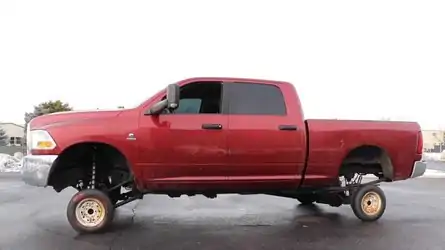

Admittedly, at <4k pounds, I was focusing on max and ultra-high performance 'car' tires of appropriate size. For that, the best available sizes are only for 20's. If stepping down to 'sport truck' tires, there may be some acceptable 18" or 19" options too. But pretty much anything of worthwhile performance will require replacing the 17's, not just the tires that came on them... Or end up looking kind of like this:
