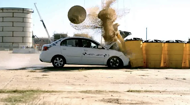

Fill your frunk full of beer/soda cans and ice and it'll double as one of those highway water barrels.
