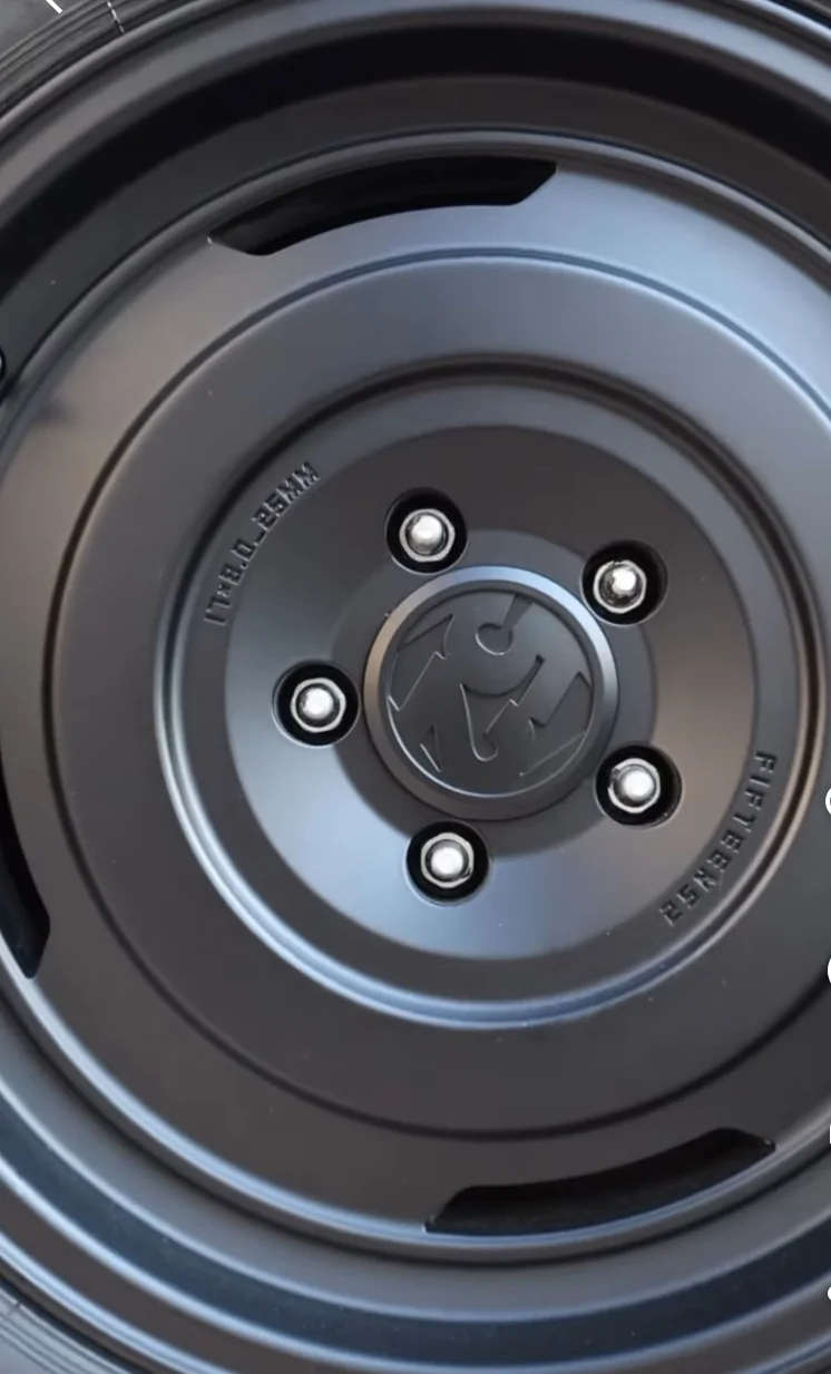

Has anyone been able to get any specs on the stock wheels? Interested in bolt pattern, width, and offset. Curious to see if there are any lighter weight 17'' wheels out there that may fit.
I cannot verify accuracy, but checkout this closeup of the stock steel wheel I located on social media. It’s stamped 17*8-25 mm. Which I believe translates to a wheel diameter of 17 inches, 8 inches width, and offset of 25mm. Does this help?

I cannot verify accuracy, but checkout this closeup of the stock steel wheel I located on social media. It’s stamped 17.8-25 millimeters. Which I believe translates to a wheel diameter of 17.8 inches and offset of 25mm.
Nice find, but no, it's stamped 17x8.0_25 which means diameter 17, width 8, 25mm offset.
It's also stamped fifteen52, which is an aftermarket manufacturer that makes those rims in 5x120, 5x130, and 5x150:
https://fifteen52.com/products/analog-hd-asphalt-black?variant=41203780190274
I'd wager that they'd cut a custom product with a bolt circle of 5x114.5 if an OEM asked nicely.
So those look like steelies but are actually aluminum, which is interesting. I love the look of the steel wheels, but you might get slightly better range with lighter aluminum rims.... Those are a little out of my price range at MSRP but at least they exist!
