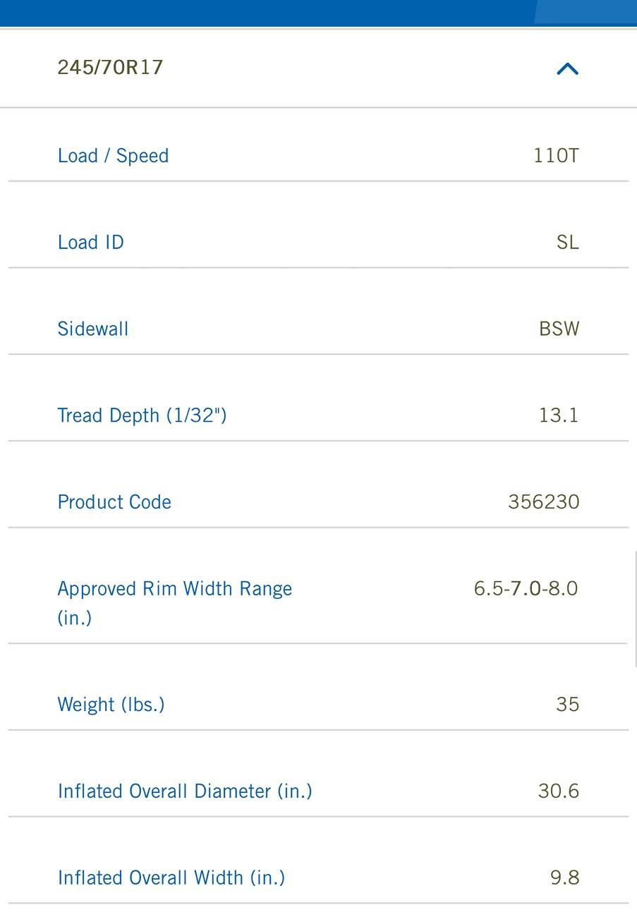

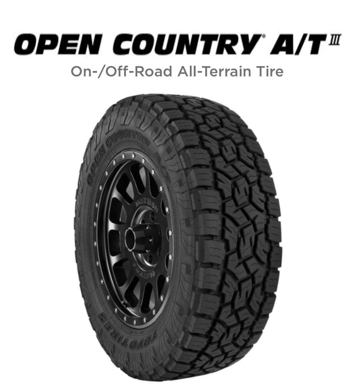

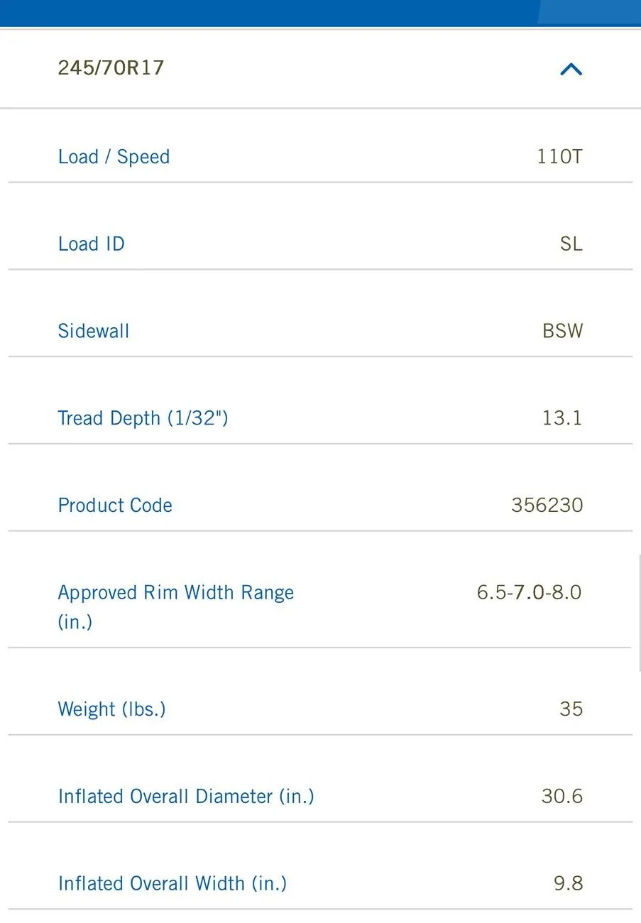

Let’s keep this tire thread going. Right now, my number one contender is this Toyota Open Country AT3 in 245/70R17, because it’s quite light, and I think it’ll look plenty big on the tiny little truck. Pic & specs below. I’d probably look for some 8” wide alloy wheels for them. Has anyone else been picking out tires?

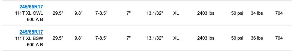

ProTip regarding Toyo Open County AT III tires:
The OWL (outline white letter) and BSW (black sidewall) versions in a given size are not the same tire because the white lettering isn't the only difference.
The BSW tire has larger lugs (same pattern, just larger and with wider gaps) and it has a beefier, more aggressive sidewall. The OWL version lends itself slightly more toward highway driving.
The OWL version is only available in some sizes, including the Slate's stock tire size (245/65R17). In that size it's listed at two pounds lighter than the BSW version.

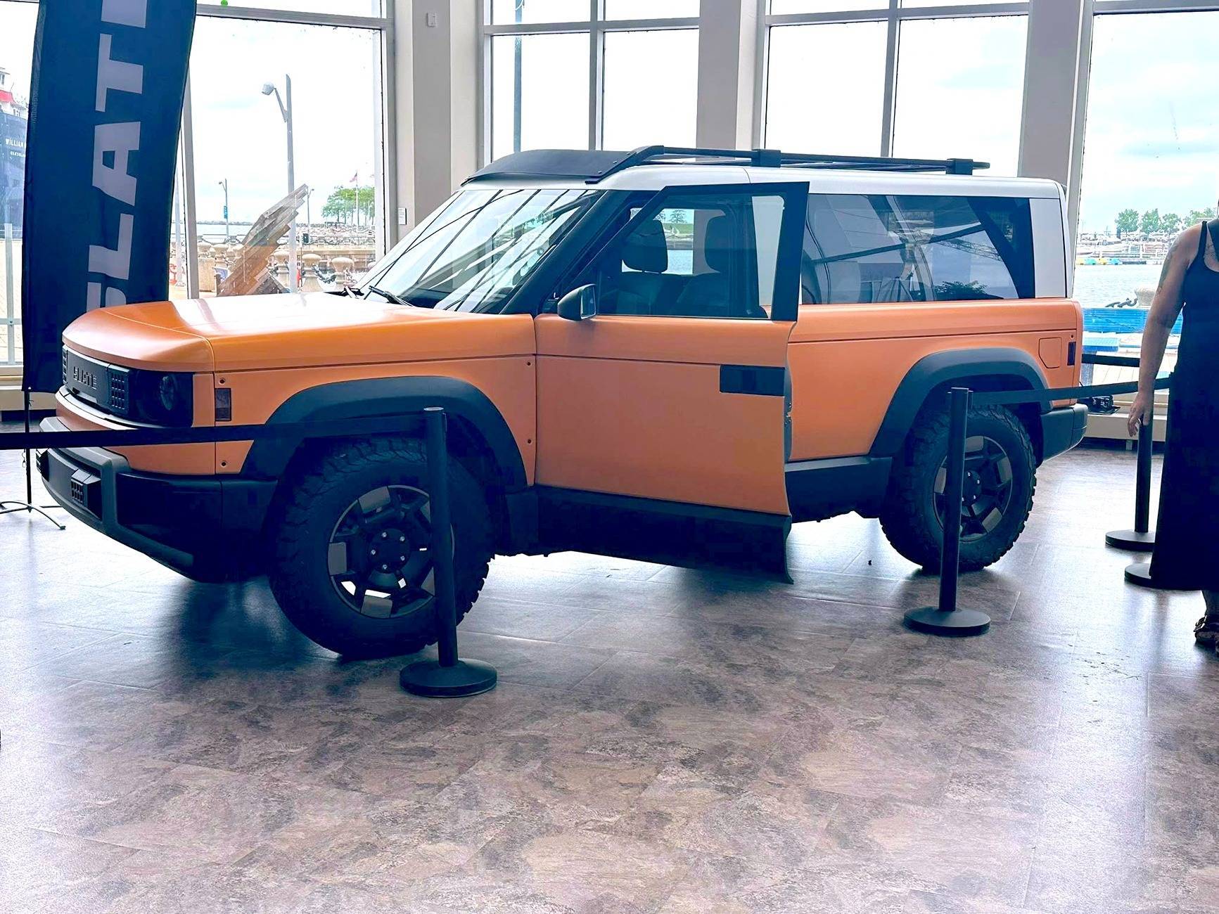

Photos of a demo Slate with 245/75R17 tires and a 2" lift are in this thread.
Repeating what I wrote there:
That's a 49-pound tire. It's probably ~15 lbs heavier than the stock tire. It's also 2" taller. Gotta wonder how much that affects acceleration, braking, and range.

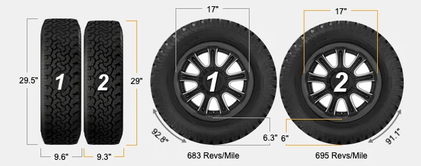

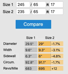

235/65R17 is ever-so-slightly smaller than the stock size, so it lacks the drawbacks of installing larger-than-stock sized tires (if you don't choose a heavy one).
it's a common stock tire size for SUVS, so there's an abundant selection of appropriate-weight Standard Load and Extra Load All-Terrain tires to chose from.
As an aside, there are lots non-AT tires available in this size too, including Michelin's popular CrossClimate2 and CrossClimate SUV tires with their attractive pointy tread pattern. There's also a Bridgestone run-flat All-Season touring tire available.
The width is 1/3" narrower than the stock 245/65R17 size.
The diameter is 1/2" smaller than the stock 245/65R17 size.
235/65R17 (29x9.3) - Speedo Error: 49.2 @ 50mph (-1.7%)
BFGoodrich All-Terrain T/A KO3: 45 lbs, 29.1" (Load Range D)
BFGoodrich Trail-Terrain T/A: 29 lbs, 29.1" (Standard Load)
BFGoodrich Trail-Terrain T/A: 36 lbs, 29.1" (Extra Load)
Falken Wildpeak A/T3W: 31.1 lbs, 29.1" (Standard Load)
Falken Wildpeak A/T4W: 38.2 lbs, 29.1" (Standard Load)
Falken Wildpeak A/T Trail: 32.5 lbs, 29.2" (Standard Load)
Falken Wildpeak A/T Trail: 35.1 lbs, 29.2" (Extra Load)
Toyo Open Country A/T III: 34 lbs, 29.1" (Extra Load)
Goodyear Wrangler Workhorse AT: 30 lbs, 29.1" (Standard Load)
Heaviest tire: 45 lbs
Lightest tire: 29 lbs (16 lbs lighter!)
235/65 and 245/65 visual and data comparison:
Slate Auto Pickup Truck Taller 17" All-Terrain Tires for OEM Wheels 235-65-17_Compare_Stock
Slate Auto Pickup Truck Taller 17" All-Terrain Tires for OEM Wheels 235-65-17_DataCompar
