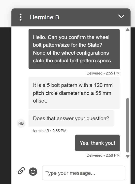

What is the bolt pattern of the wheels?​
Surely it's known now. It wouldn't be a last-minute switcharoo item.​
I'm looking for the nnn in "5 x nnn".​
2,670
What is the bolt pattern of the wheels?Surely it's known now. It wouldn't be a last-minute switcharoo item.I'm looking for the nnn in "5 x nnn".
Reply:
Thanks for reaching out!​
We’ll be releasing finalized wheel and fitment details closer to production so please stay tuned.​
What I can share is that we’re using a very common bolt pattern specifically to give owners flexibility when choosing wheels. The goal is to make it easy to run widely available aftermarket options without anything proprietary or unusual.​
1,452
1,670
Yeah, trying to pull spec details from the reps seems to be a non-starter, even in something as simple as that. They must have instructions to not give any specs outside of what has been officially released. They probably mostly do get questions that have answers that can be found on the website or in videos, and that is what they are mostly there for.
