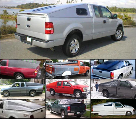

Apparently this is a thing and the main impact of drag is actually the tail of the vehicle. Apparently tonneau covers help by about 5% but tapered caps could be 15-20%. Might be interested if slate sold one. I guess the shape of the cybertruck makes more sense.
If someone make one of these (in slate gray) that could still open to access the bed, I would pay 1K for it.
https://ecomodder.com/blog/aerocaps-for-pick-up-trucks/
Along with other mods, improved mileage from 21mpg to 30mpg in winter, and 27 to 35 in summer, with around 2mpg of that increase specifically upon replacement of the original non topper with this one.

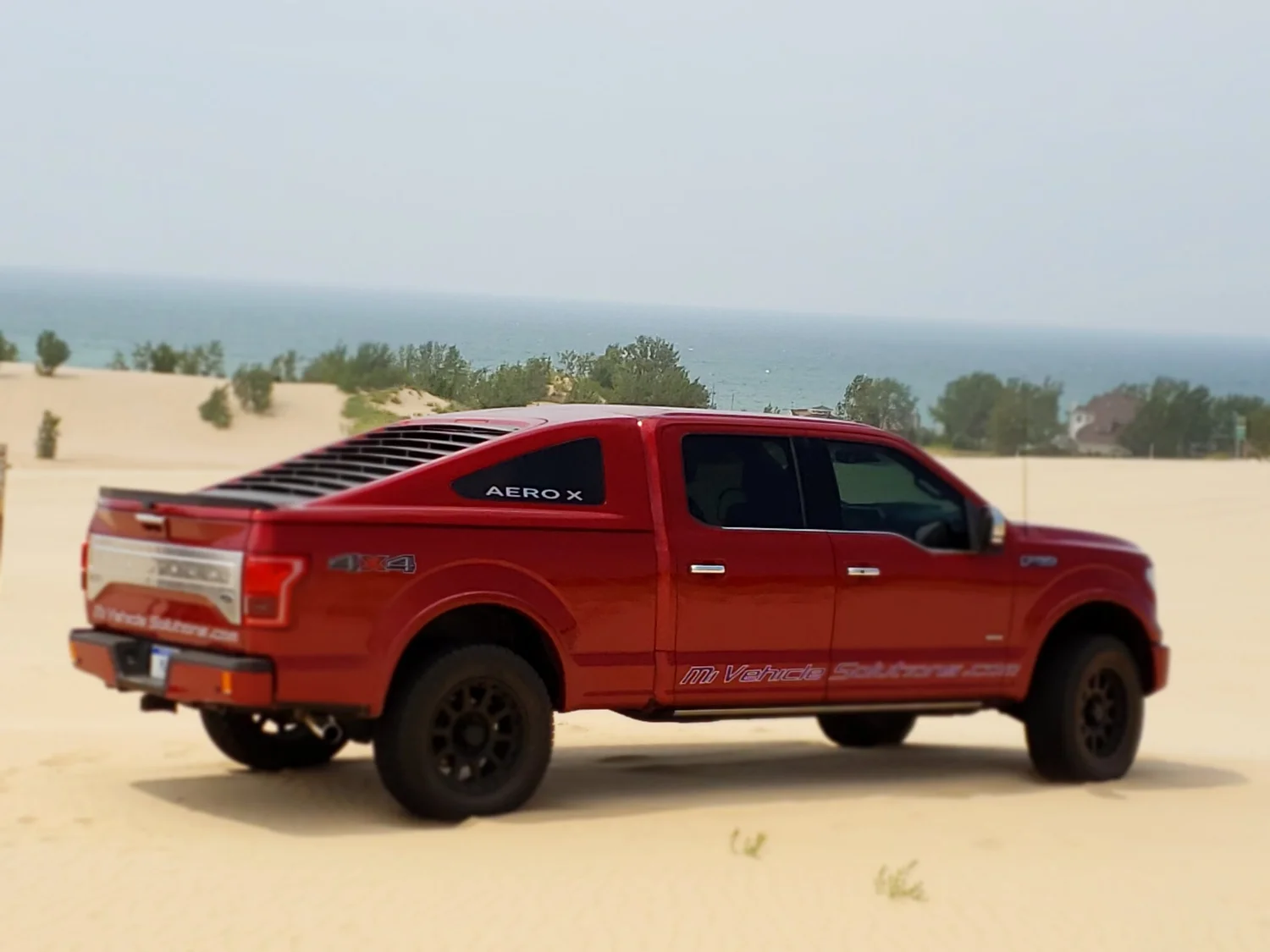

A company called MVS built an Aero X Baja cap (for Fords) that looks pretty good, IMO:
Slate Auto Pickup Truck would anyone buy an aerodynamic pickup cap? IMG_7927

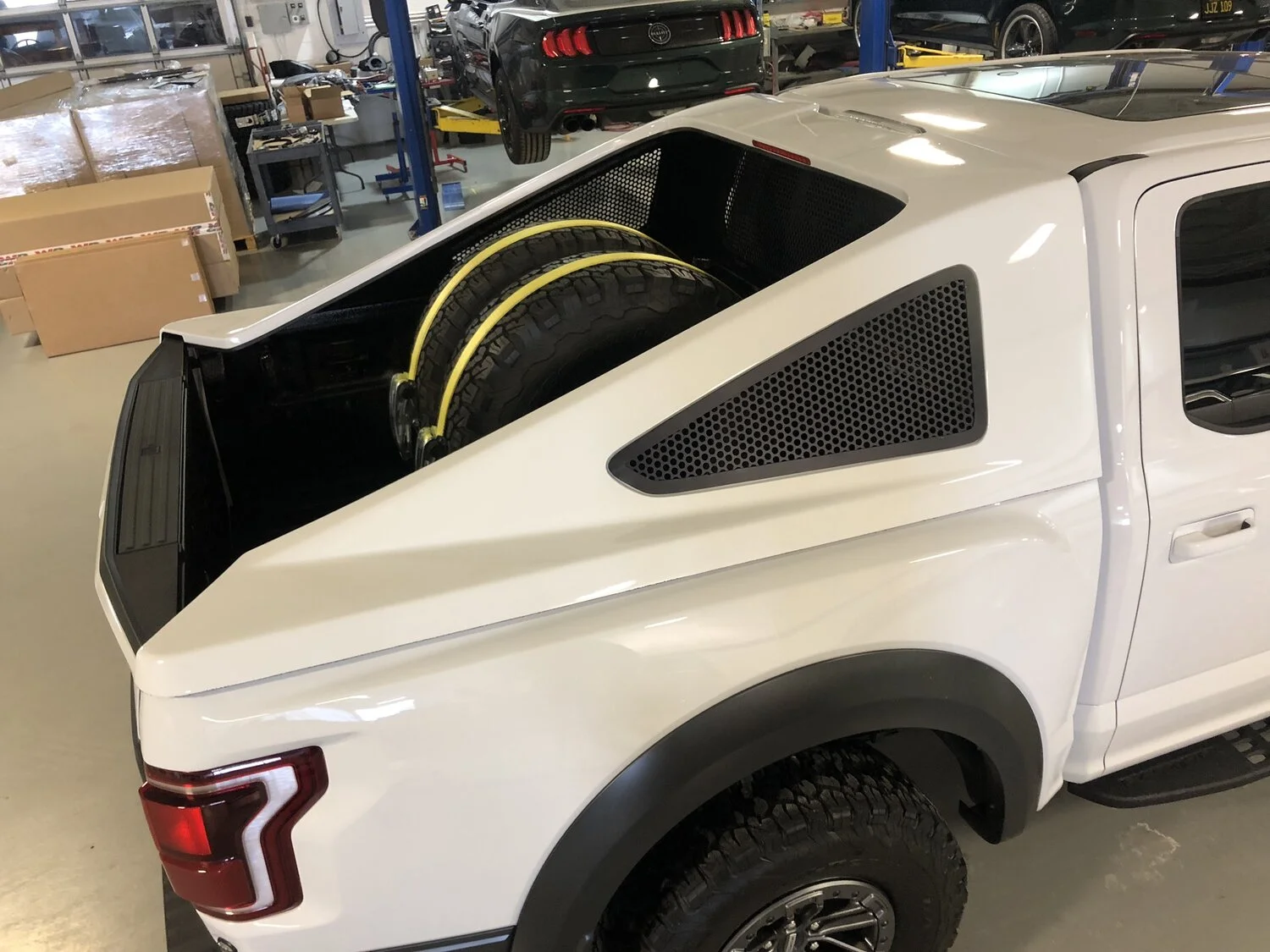

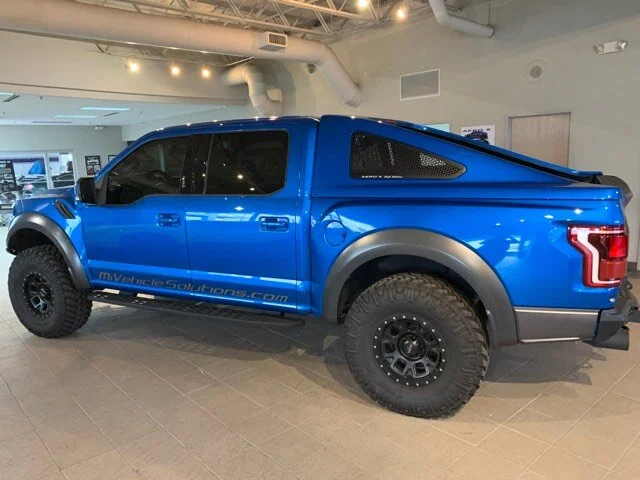

And they have fastback versions too:
Slate Auto Pickup Truck would anyone buy an aerodynamic pickup cap? IMG_1891
With the louvers, they're clearly aiming for detached flow. I'm not sure that's the right move for efficiency, but it looks good!

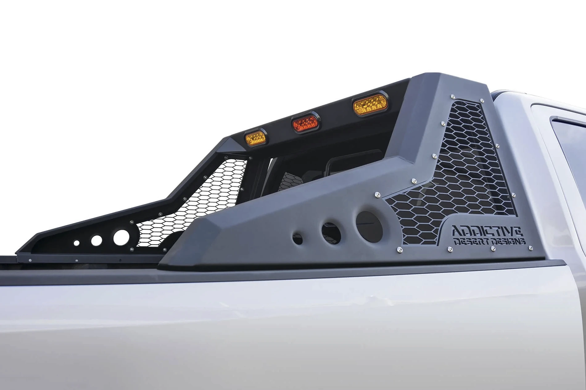

Maybe something less efficient but more usable could be built: if the rear triangles were solid but only reached halfway down the bed, they'd keep some flow from coming over the rails and impacting the inside of the tailgate. I think the off-road guys call this a "chase rack"? Something vaguely like this, but solid, maybe some lexan triangles, instead of perforated, following the stock Slate lines and keeping the flow managed further down the truck bed:
Slate Auto Pickup Truck would anyone buy an aerodynamic pickup cap? addictive-desert-designs-truck-bed-rack-ggvf-c995541440103-honeybadger-chase-rack-1186159479

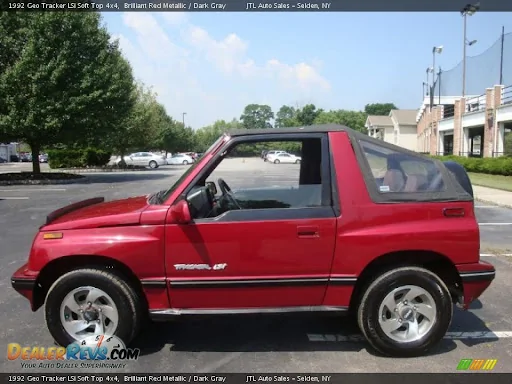

I toyed with the idea of one for my Tracker. They sold a soft-top variant of it for Suzukis. The rear visibility is a concern for sure with a rigid one. At least in the Slate I wouldn't be worrying about rear headroom!
Slate Auto Pickup Truck would anyone buy an aerodynamic pickup cap? 1782645646307-3
