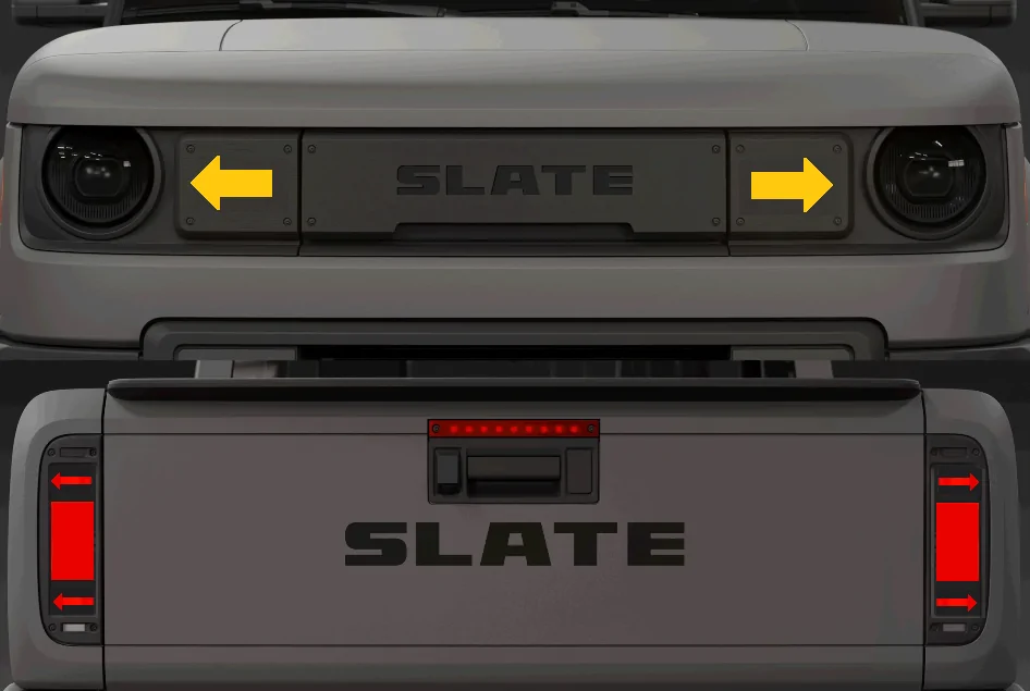

I got a couple ideas for light covers. One good thing about a later delivery window is time to print your own stuff based on the files Slate will be providing. Hopefully they will start sharing them before the first deliveries begin.
I like the arrows. Was thinking the same thing. Reminds me of the old school busses.
