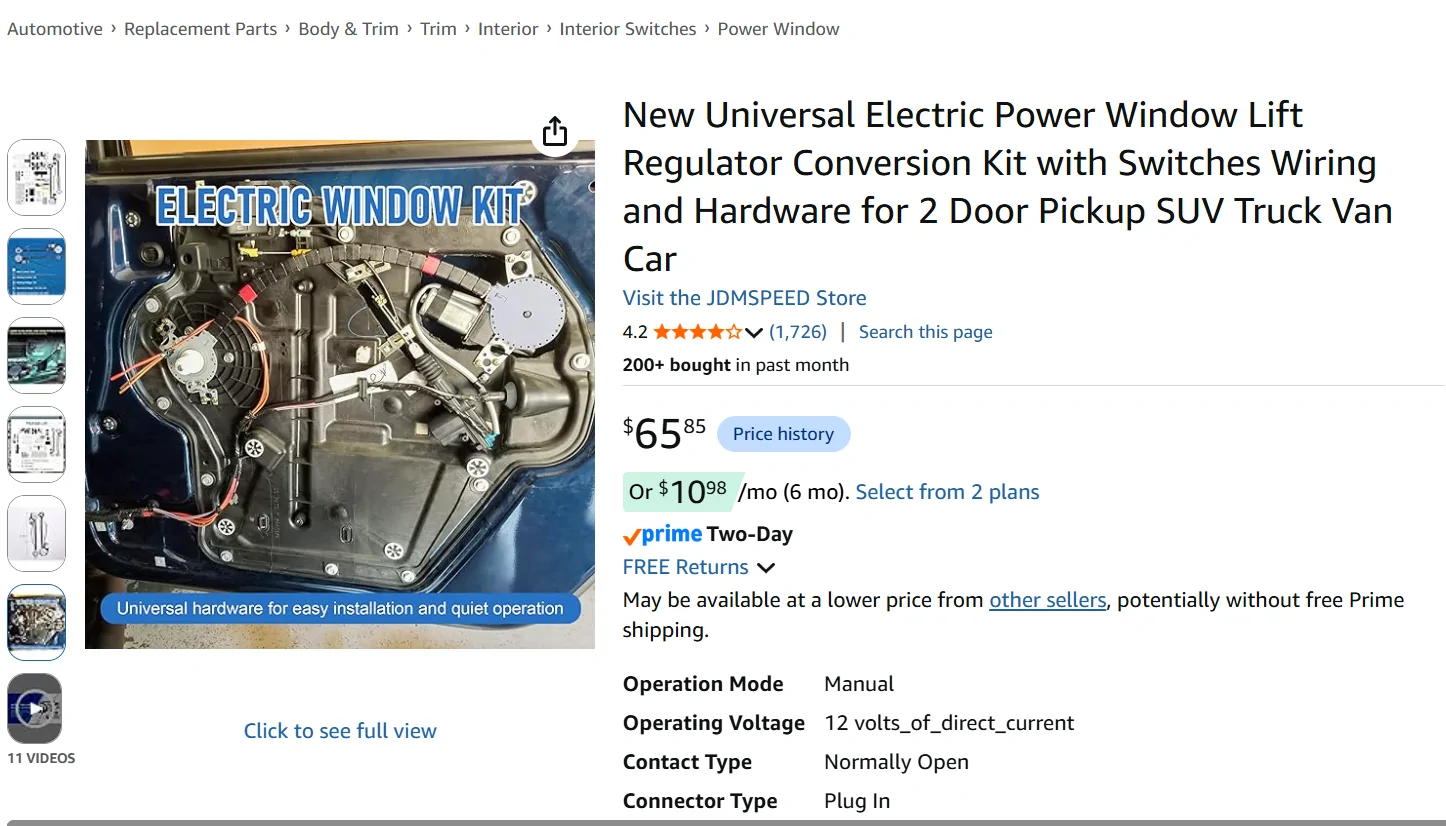

I must have missed part of the discussion. Is there some reason why the common aftermarket kits won't work? Like
They'll work, they just won't pass modern window regulator or door impact safety standards. Someone could get hurt if they're leaning or reaching through the window opening with their neck or finger and you close the window on them, and if you get T-boned then your knee will impact the window motor at high speed.
I was curious about this so I asked ChatGPT about the regs. This was the response:
1. Power windows generally may close only in limited conditions
Under FMVSS 118, a power window may be closed only in certain circumstances, including when the ignition/key system is in ON, START, or ACCESSORY, by unassisted manual force, by continuous exterior key/lock activation, by close-range continuous remote activation, or during the short retained-accessory period after key-off before a front door is opened.
So a simple aftermarket kit wired to work any time, regardless of ignition state, could create a compliance problem.
2. Anti-pinch / auto-reversal is required only in some cases
FMVSS 118 does not say every power window must have anti-pinch in all cases. But if the window can be closed in ways outside the permitted S4 operating conditions, then it must meet the automatic reversal requirements in S5.
the closing action generally must be a pull-to-close motion: pull up if mounted on a horizontal surface, pull out if mounted vertically, etc.
That is why modern cars usually have rocker switches you pull up to close, not flat pushbuttons that close when pressed downward. A cheap universal kit with generic pushbuttons may be the biggest red flag.
NHTSA has said the make-inoperative rule generally does not apply to owners modifying their own vehicles, though it urges owners not to degrade safety.
I checked, and the cheap kits I saw do have basic rocker switches, but separate pull to close switches are readily available as well. The motors themselves are designed to be mounted inside the door, so I don't think impact safety is an issue; it's more a question of whether there's a usable open space to mount it it.
I think this would be a fairly easy owner installed option. I wouldn't wire it direct in any event; I'd have to think about whether I felt the rocker switches were actually a danger in my situation or not. I'd even consider mounting the switch directly above the existing handle crank hole and jury rigging an extension so I could plug a handle in and crank manually if needed.

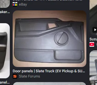

Having, very briefly, looked into this upgrade for my Geo, a truck that wasn't designed from Suzuki to have power windows, I can't imagine it'll take up too much space. They actually do a really good job packaging the power windows into a fully flat door-card as a dealer-addon.
Slate Auto Pickup Truck Electric Windows Configuration. 1783908547038-5v
How did they add power windows? A simple pod that hid the motor with the switches stuck on:
Slate Auto Pickup Truck Electric Windows Configuration. 1783908688062-q
Exactly what Slate needs to do.
