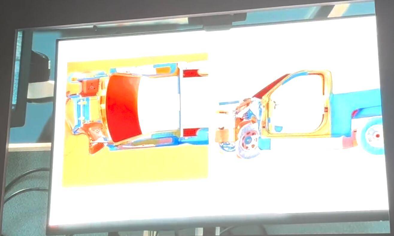

The problem is not that it's too much of a stretch, but that it's not enough of a stretch.
Look at this crash simulation photo:
Slate Auto Pickup Truck Extra Cab Kit? screen-shot-2025-04-24-at-11-55-23-pm-jpg
Notice how the bed buckles near the back of the cab in a frontal collision. It seems likely that the bed is included in the crumple zones in pickup form, and needs the full extended 'roll bar' setup to safely put people there.

It is never going to happen for this model. The bed side rail structure is integral to the frame.
A separate model in the future maybe.
