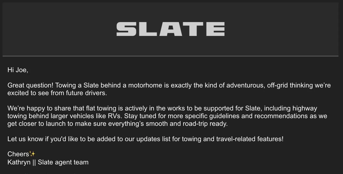

I asked about flat towing support for the Slate truck and here was their confirmation:
Hi Joe,
Great question! Towing a Slate behind a motorhome is exactly the kind of adventurous, off-grid thinking we're excited to see from future drivers.
We're happy to share that flat towing is actively in the works to be supported for Slate, including highway towing behind larger vehicles like RVs. Stay tuned for more specific guidelines and recommendations as we get closer to launch to make sure everything's smooth and road-trip ready.
Let us know if you'd like to be added to our updates list for towing and travel-related features!
Cheers:+
Kathryn || Slate agent team

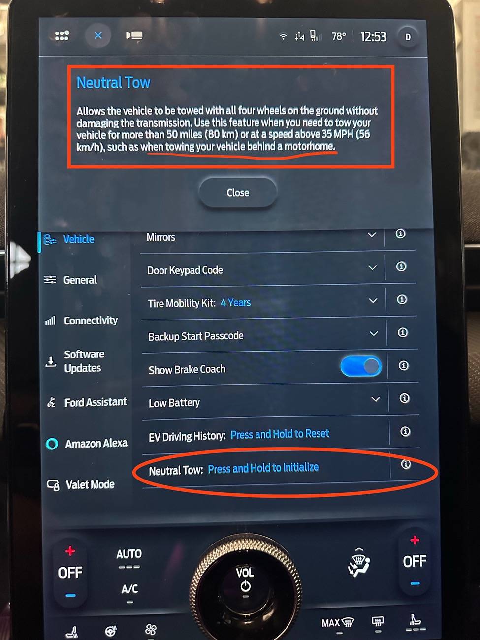

Well there is one now..The Mustnag Mach-E. Could not believe when I found this on my car...
