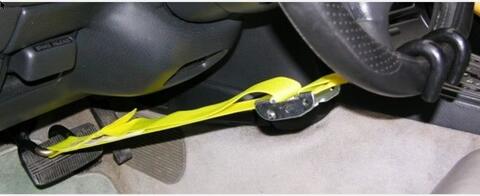

I agree that small light trailer would be your best option. So you can’t dolly a vehicle with front tires on the ground? Haven’t I seen tow trucks towing that way?
Each car is different but they sell little tow-straps you can hook to the bottom of the seat rail for manual seats to hold the wheel in one spot. I know some of my older cars have a few degrees of movement on the wheel even when locked. Some people tie the seatbelt around it and buckle it in but that might not be good for modern seatbelt retractors/tensioners.
