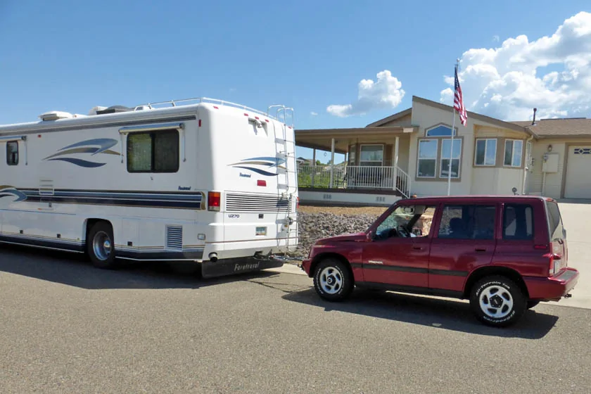

A lot of people do use dollys for front wheel drive vehicles. But putting the back wheels on a dolly and towing backwards will make the front steering turn sideways. Plus you have to put removable rear lights on the front (facing rear) towed vehicle. And you have to maneuver and stow the dolly when camping or at home. If the Slate won't flat tow, I'll forget it and keep my Geo Tracker.
