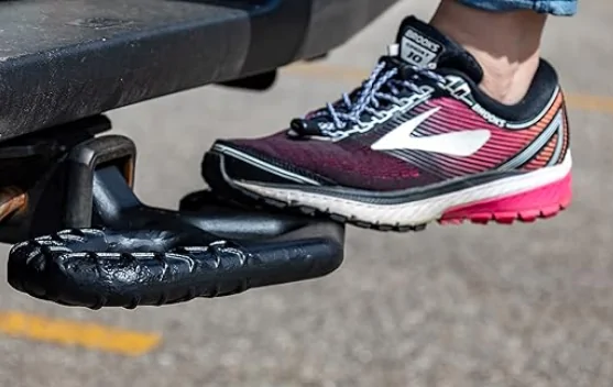

It's more a bicycle carrier or hitch mounted tray.
or an Old Man Step! :)
