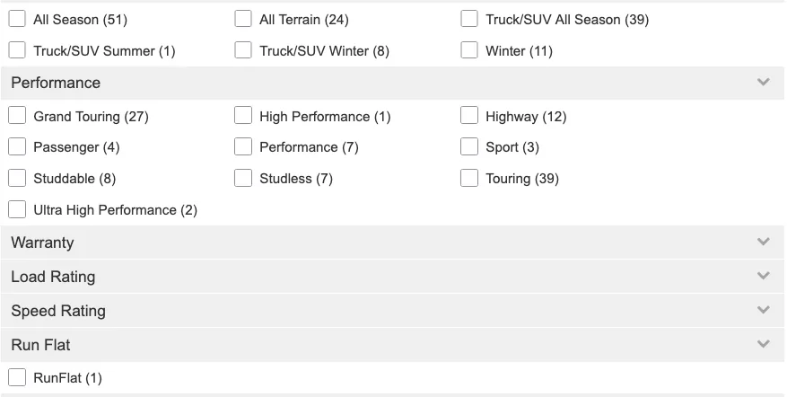

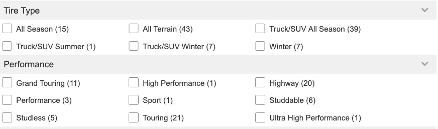

56
2,635
4,894
The "next size down" from stock, 235/65R17, is only 1.7% smaller in both radius and diameter. There are some good tire choices in that size, probably because of the type of vehicles that come with that size from the factory.
245/65R17:
Slate Auto Pickup Truck Good EV snow tires? 245-45-17
235/65R17
Slate Auto Pickup Truck Good EV snow tires? 235-45-17
690
1,294
245/65R17:
235/65R17
I think if you got 235/70R17 or 225/75R17 they all have the same outside diameter so would be a better sub for the OEM size. I don’t need snows in Georgia but plan to replace with 225/75R17 after I wear the OEMs out.
