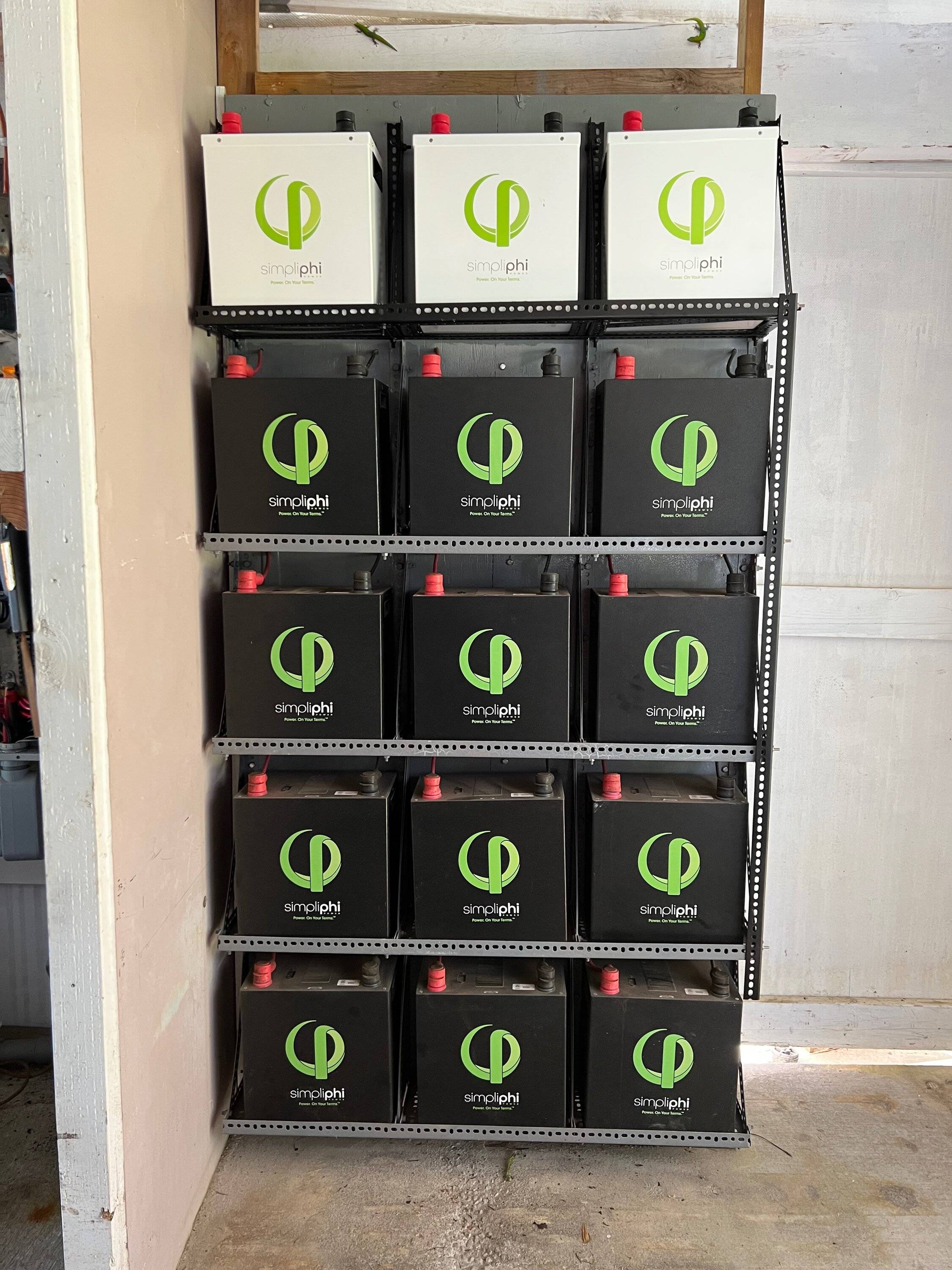

During this time we started building our house and in 2007 turned on 48volt Outback based system, 4.5kw of 125w PV ($700/panel those days)with 2 Outback CC, 2 FX 3048 inverters, 3 kw each, 12 Rolls Surette 4v premium LA batteries and associated meters and controls to make it as much an integrated system as possible. I assisted in the design and install of this system so to be able to self maintain. Could have bought 2 Slate trucks. Over next couple years I added more PV, 2 more CC, 2 more inverters, undated controls and meters until I could actually monitor and control via internet. Was able to deinstall the cottage system and power from the house system. 2017, RS batteries started showing age, almost 10 years old. I researched alternatives and at urging of local supplier installed 21 Aquion saltwater 48v batteries. Within months, that Obama company went bankrupt and the professor went back to teaching after selling to Chinese company. Less than 2 years later was running generator hours per day inspite of upgrading all the old PV to 14kw. Nov 2017 I replaced the Aquions with 12 SimpliPhi 3.8 kw LiFePo batteries. Later that month I assisted my installer replacing the FX system with a new Outback Radian, 12kw system. Had intended to do it myself but his installed price was better than my equipment only price. Two years ago, I built a new PV array of 4.4 kw and added 3 more SimpliPhi LiFePos for a total of 57kw. We have a very robust system. This winter I upgraded to 16kw of inverters. Daily use is around 35kwhr, more if running the hot tub.
The heart of system. Before latest upgrades. Newest 12 PV array, 3 batteries, and a few assorted pieces not showing. Need newer pic.

That is a beast of a system you've built over the years. To solve the charging issue without taxing your SimpliPhis, you should look into a smart EVSE like the Zappi or Emporia that features 'Solar Match' logic.
I had my system installed by Wolf River Electric here in Minnesota, and they were the ones who helped me configure the CT clamps to prioritize the house batteries first.
Once your bank hits its target voltage, the charger automatically diverts the excess 4.4kW from your array straight into the car. It’s a very clean way to turn your EV into a literal dump load for that extra midday production.

Thanks, I’m on track to install another 8.6 kw of PV, but will check this out.
