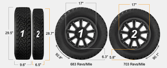

I did quick dive into space saver donuts. 🍩
The wheel for those is three inches narrower than the stock wheel (4" vs. 7").
There are lots space-saving tire sizes that fit on a 17"x4" wheel.
There's a vendor in eBay that specializes in selling "original spare tires". Prices are reasonable, however...
If you're buying a used spare tire, age of the tire would be something to watch out for.
We don't know wheel specifications, so finding a wheel that fits is TBD. Obviously you can buy a new, fresh tire once you have a wheel.
An available size that's not too far off in diameter from the stock 165/90R17 size is 165/90R17. Here's how those two sizes compare:
Slate Auto Pickup Truck Using Rear Footwell Space for Spare Tire Storage (Design Ideas) Compare_165-90-17_Spar
