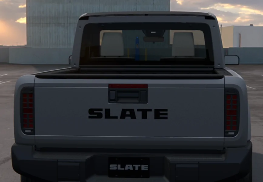

It was there, look in the updated maker, third brake light is in the tailgate now :(

So I guess the design decision to move the 3rd brake light to the tailgate reduces the complexity in the SUV kit. The brake lamp would have needed to move to the rear window. This approach is suitable for both the square back and fast back SUVs. Kudos to the Slate design team.
Now for the ‘not so good’ news. If you’re carrying cargo or sheets of plywood that requires driving with the tailgate down, the 3rd brake lamp is going unnoticed. Not to mention the rear backup camera, which is useless as it faces the pavement in this scenario.

I will gladly take the simplified roof. Better chance of getting moon, sun, or convertible roof top.

Yeah, I get why they did it, but agree on the not so good points. It shouldn't be terrible to add a 3rd brake light back to the roof, and as I said I'd like cargo lamps there too, and I'd move the backup camera to the license plate area like I have it on my Ranger, just a generic bolt on type but it works great even if the tailgate is down. Also not a fan of wiring going to the tailgate, that should be just a big old slab of material with a handle in it.
This is the thing with the Slate, I'm not as concerned about being able to tap into or rerun things, it's not all canbus computerized, I'm sure the brake light circuit is a regular old 12v line run from the cab to the back, and the camera is probably a composite video type, or even better I put in an aftermarket stereo and run my own backup camera there and just unplug/remove the one in the tailgate, 3d print a fill plate and wrap over it.

Interesting, is it the same on SUV? I can’t imagine they would have 2 light location, that’s a mess of increased manufacturing loop holes to accommodate, and especially when the back of the top isn’t “removable” in a way you would drive down the road.
okay I see it now, as other stated it is definitely simpler. Also means the tailgate handle, brake light, and camera are on one single holder. As far as the downsides, it’s fine in the Gladiator

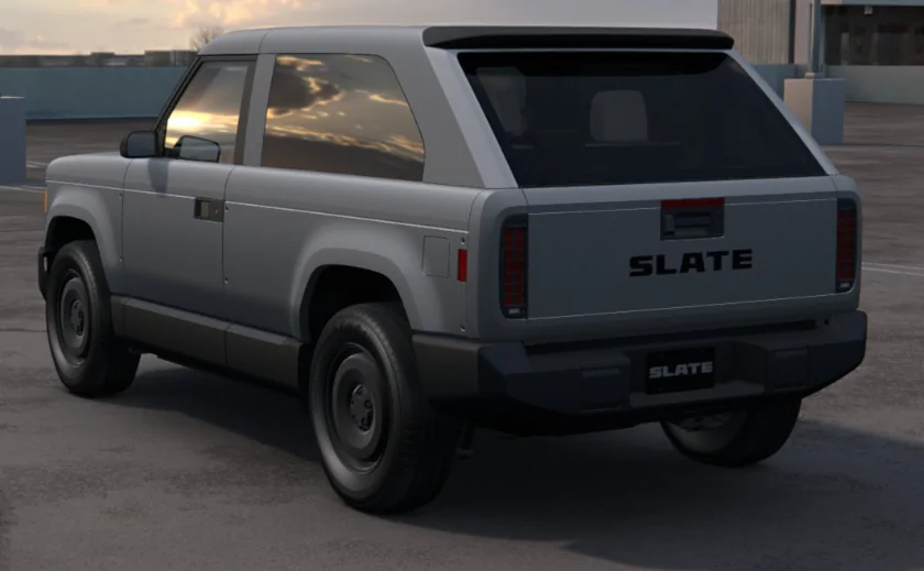

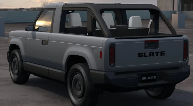

Yeah, I think as cadblu mentioned that's 1 less thing to fiddle with when applying the kits, or even like the open air kit the glass goes away and the brake light is all set:
