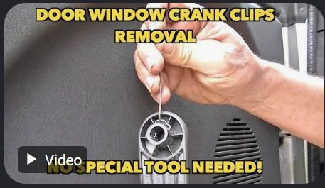

I use this pick, slide into the slot, torque the hook towards the handle, retract.
Slate Auto Pickup Truck Window Crank Position? Screenshot 2026-08-09 105503
Slate Auto Pickup Truck Window Crank Position? Screenshot 2026-08-09 105557
Slate Auto Pickup Truck Window Crank Position? Screenshot 2026-08-09 105545
Or this.
